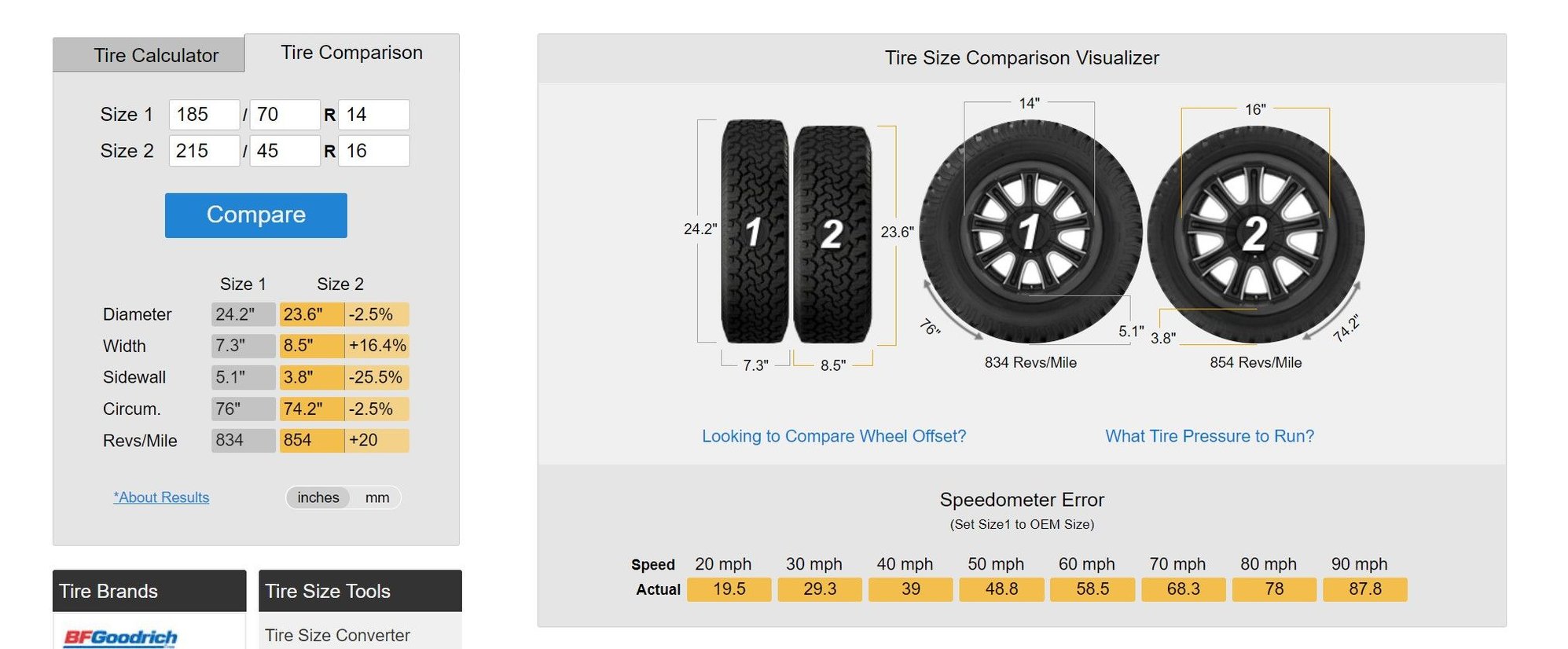

hi there, so im trying to decide between 215/45R17 and 215/45R16 wheels and tires for my es civic, i definitely prefer the looks of the 16 inch however the diameter of the wheels and tires is smaller than stock, which as far as i can tell will increase engine rpms at any given speed and make the speedo less accurate (mine already says that im going about 3mph over the speed i actually am, so this would make that worse still). my least favorite thing about this car is the 1st gear being extremely short and 5 gear also being too short (3100rpm @ 59mph) both of which would be exacerbated by the smaller diameter 215/45R16. i had a look at 215/50R16 but there are barely any tires sold in that size over here and none of them were sporty at all. is there anything i can do to combat this or will i just be stuck with it?

here is a comparison between the stock 185/70R14 and the 16s

yeah true true but i cant imagine that being great for fuel econ, especially cause these new wheels and tires are going to make it about 100rpm higher too
It's fine, they get good mileage. They're designed to run at that rpm at highway speeds
