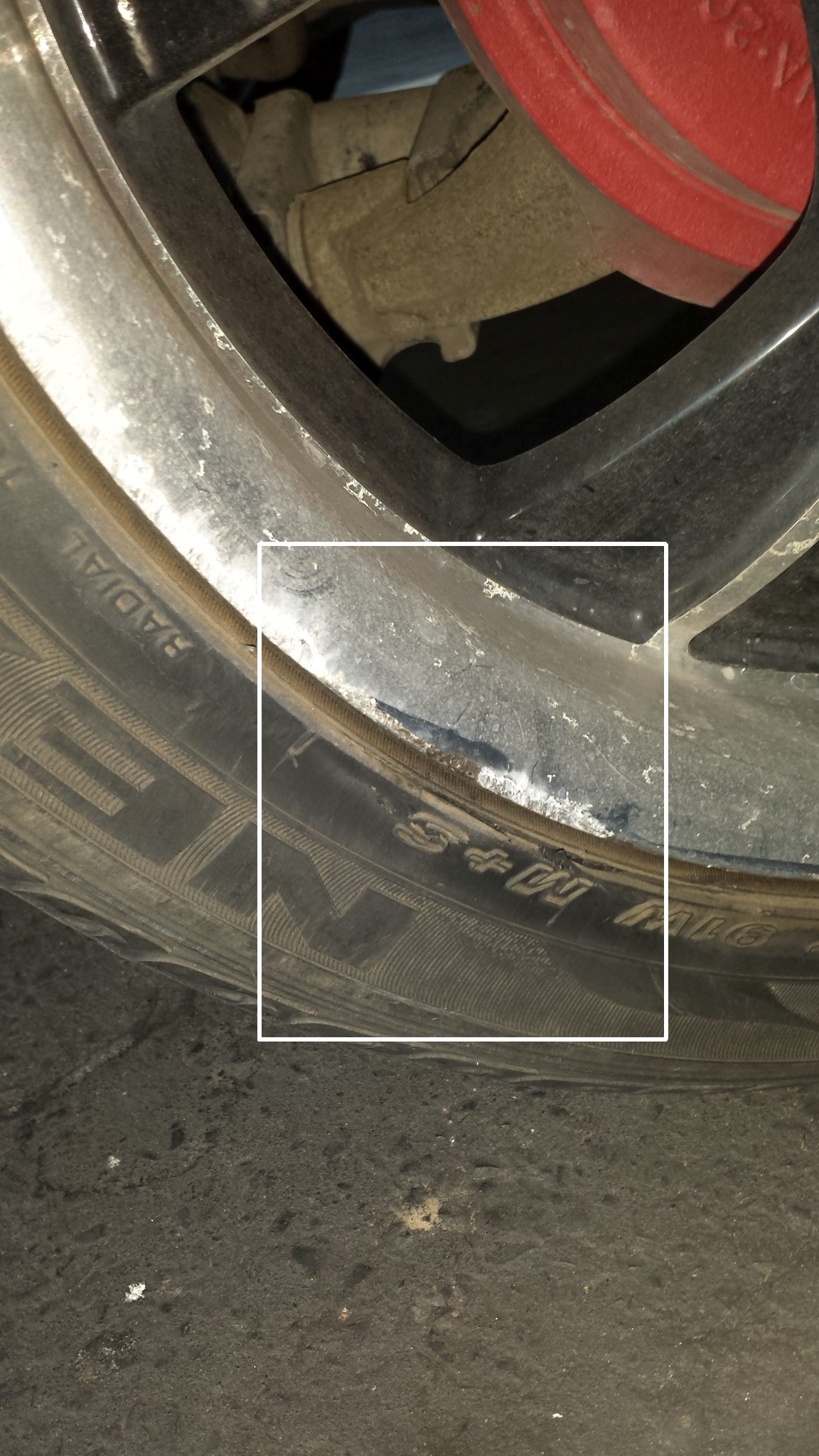

jumped the curb today and there's a small tear on tire
Old Jun 22, 2016
bo_red's Avatar
Joined: Apr 2015
Posts: 41
bo_red will become famous soon enough
I was in a hurry and apparently I turned too fast and right rear tire jumped the curb.
And I just noticed that there's a small tear on the side of the tire shown in the picture.
Should be worried?
Do I have to get a new tire?
Thanks for any info.
edit.
I still can't post picture...
http://imgur.com/lBdR3j4

Re: jumped the curb today and there's a small tear on tire
Looks ok but it's hard to tell how deep it is from the picture.
Old Jun 22, 2016
Is there a chunk of rubber you can lift to show us how deep it is?
From here it looks superficial.....need to know how deep it went.
as requested. it does seem superficial
http://imgur.com/a/DjUOC
Old Jun 23, 2016
Posts: 15,180
Likes: 1,606
Rep Power: 367
that's the rim guard - it did it's job.
no issues there.
the rim...
Old Jun 23, 2016
^Agreed.^
Superficial.
Keep on driving, and stay away from curbs.
