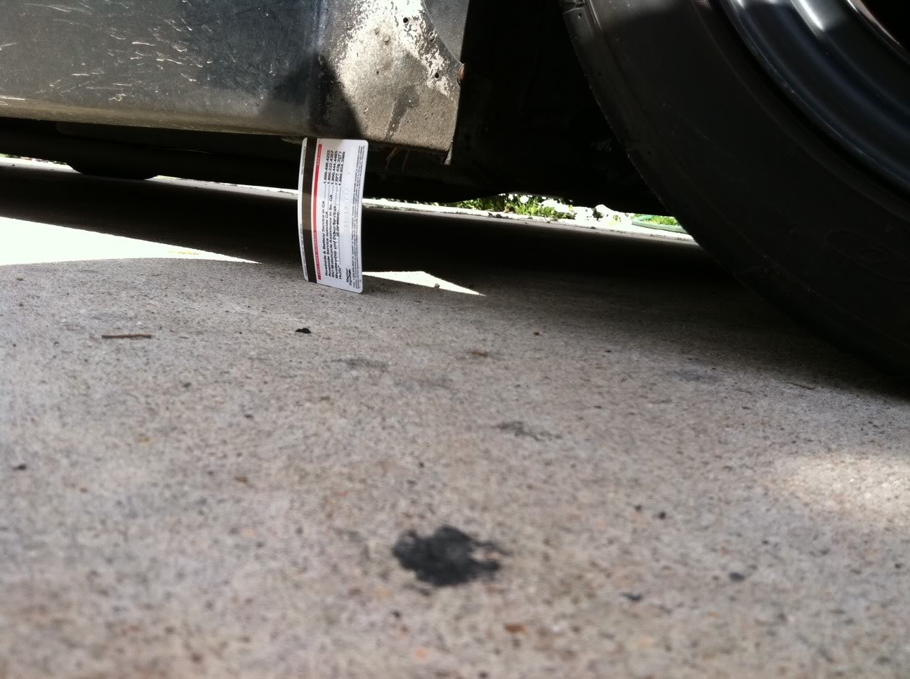

correct. my lowest point was around 4" see picture below. lolz

4" drop doesnt mean your 4" from the ground it means you've dropped 4" from stock height right?
My 04 EX is 4.25 inches from the ground in the front and 4.5 inches in the back. I dropped about 2.75 inches from stock in the front and 3 in the back on my Pro S II's. Both of my fenders are 24" and 24.25" from the ground.
I would say I have about a 3" drop all around (nice and flush )
Old Apr 25, 2012
sl33pyriceboi's Avatar
Posts: 9,196
From: SoCal 714/909/626
Rep Power: 353
Re: 17 or 18's on a 2" drop
Yes. Dropping 4in means you are dropp 4in lower compared to stock height.
