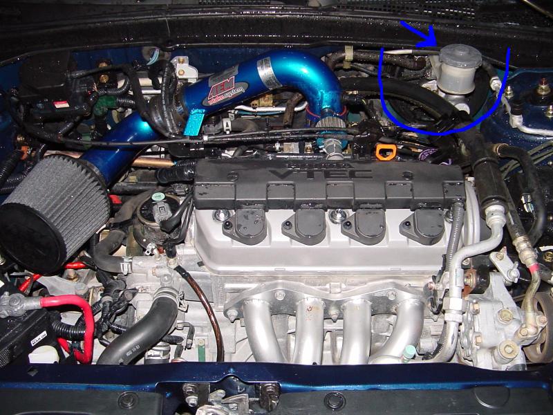

Here is a pic

Originally Posted by Alpha 5
Here is a pic
hey in that pic did u just clean ur engine bay by using degreaser and spraying down??

Old May 9, 2007
Alpha 5's Avatar
Joined: Dec 2006
Posts: 3,091
From: We are Anonymous!
Rep Power: 329
Re: Help with this brake diagram!
That pic is old, but I would go to the car wash and use the green tire cleaner on the engine then use the rinse at a distance. Water will not hurt the engine the psi will. So when you rinse it dont bare down on anything that can be damaged. Pm me if you have any other questions. Don't want to ruin the thread.
