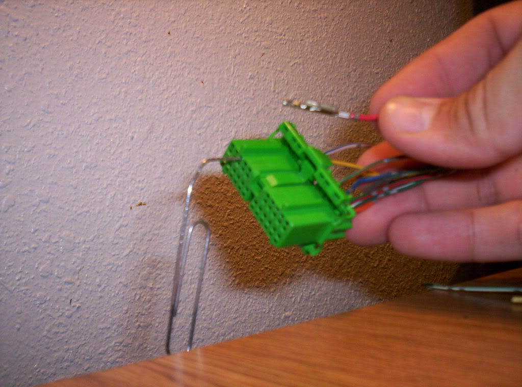

Thanks for your offer to walk me through it. I actually figured out a cheap way around the issue. I went off to the local pull-a-part and yanked part of the wiring harness that would tell me how everything is hooked together. My Honda is a 2002 so it's a 7th gen model.
Since I actually pulled the part of the harness that has the temperature controls, fan controls, and hazard lights, I figured I'd just swap the pins out of my bad/severed connector and attach the new one. The problem I've run into now is that I can't for the life of me disconnect the pins. I'm not sure what the correct technique or tool is for these.
I found this other person's post using a paperclip for this disconnecting process, but I have not been successful with a paperclip, metal dental pic, or a generic pin disconnecting tool I assume because it doesn't have the right size/shape. Anyone know what the real honda tool to perform this operation is? It would also be good to know what the proper technique is to release the pin from the plastic connector; insert probe from wire-side, non-wire side? Do you just insert and then pull, or do you have to use finesse to unlock it like the picking of a lock?
This is a pic from the post I found. It has the same connector I'm trying to de-pin. In my efforts, I have already pulled back the retaining cap which is also seen in the picture.
