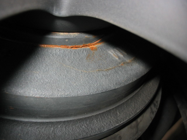

i know i'm a month and a couple weeks late, but here's the pics of what i've been talking about...
ID:	56933   Click image for larger version

It looks like it's been cracked for a while already because rust has already formed inside the crack. You need to replace it ASAP!
.... rust forms really fast around bare metal...
so, it's been a month and a couple weeks... have you replaced your drum(s) yet?
you know...no i haven't. i've been meaning to though... i should be getting it done soon. just gotta find out how much it is
it isn't gonna be cheap, man... like boiler said, if you do it yourself, expect to pay $30 (auto parts store) to $50+ (dealership) a piece for the drums... plus shoes, parts cleaner, grease, brake fluid, etc.
so maybe $150 for a diy job with honda drums/shoes and $400+ for a kind shop to do it for you, replacing both drums (with house brand).
my bro had a drum (not sure if they did both) replaced on his neon at meineke and they charged him $440.
good luck, man.
