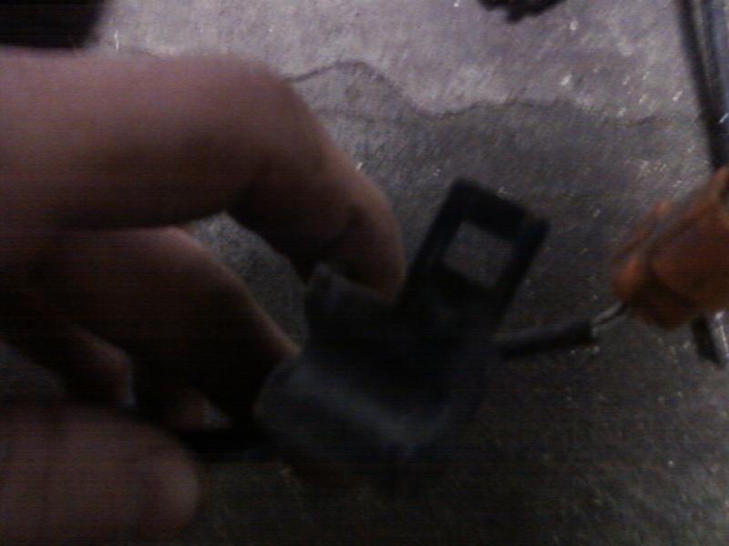

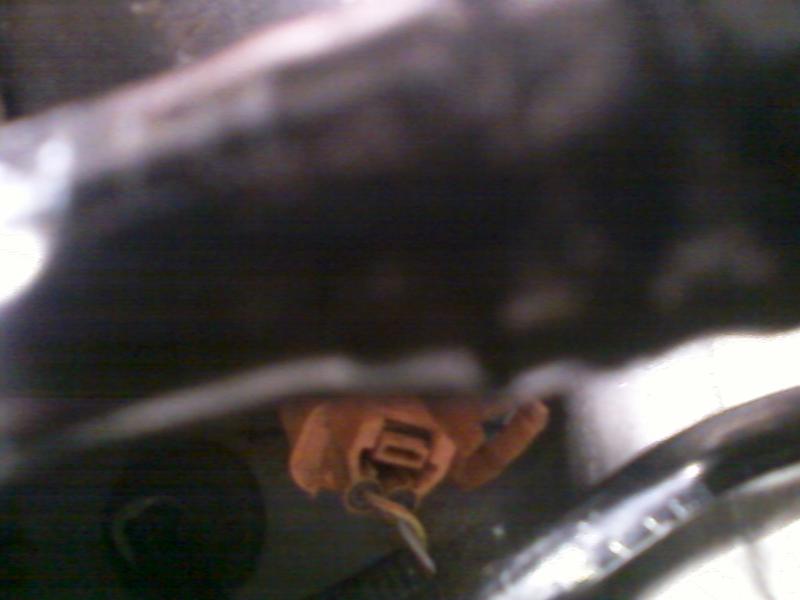

**Solved
ID:	87481   Click image for larger version

Originally Posted by Hensinger2010
anyone have a tip or tricks on how to get this plug off the mount? I've pried both ways while pulling with hands and pliers, those who have done this know its in a tight place and not much slack. don't want to break it already worried
Is this the ABS speed sensor?
