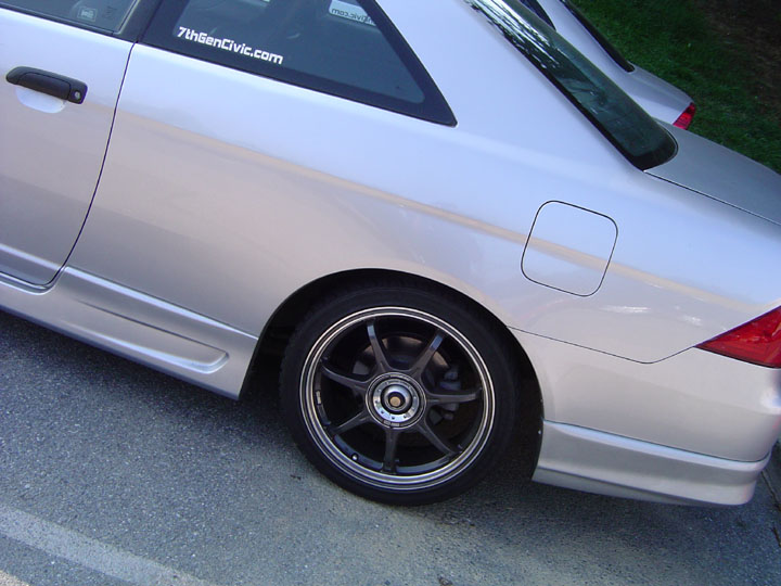

sweeteli99:
Old Aug 5, 2005

Originally Posted by skipbarber
i dont think it would matter, since those kits are designed under the assumption that it is a straight swap, so the engineers know to make the mounting points for lines/cables the same as stock, or provide a new part. and IMO, ep3 cables are more than enough.
sweeteli99:
thats the good stuff right there.
get big brake kit from an ep3, their fronts is the same as ours, and so is the rears (now that you have rear disc). everything should line up, since basically your rear suspension is now the same as an ep3, all cables, etc.
