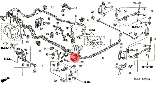

I have looked at the brake diagram of the Si and do not see anything described as a proportioning valve. Where the standard civic EX has this is a 4-way joint on th Si. The Si has anti-lock system as the EX but there is a difference at this 4-way joint/valve noted on the EX...not sure why. This item is at the front bulkhead where the rear brake lines connect and then go to the back for branching out to their respective sides. Any idea on a part # for this valve? Thanks

4-Way Joint
The part is called a 4-way joint. It is Product ID 459533 on Majestic and Honda P/N 46470-S5T-E01 everywhere else.
Hondaluver, who claims to have done this conversion, says that your brakes will work fine with the original EM2 proportioning valve.
I will be doing this conversion with new Honda parts as soon as my backordered items come in and will keep you posted... I may even take pics and post a DIY

The EX uses a proportioning valve, since ther rear drums do not require as much pressure to acutate them. Around 800 to a disk at 1200. The Si uses a joint which has not valves at all, it just mounts the same. The rear brake bias is controlled by the ABS modulator. So in the SI all the brakes get the same pressure, but if the rears begin to spin or lock, then the ABS system lowers the braking pressure to the rears.
Currently I have an EX with ABS, I have converted to the rears off an SI. I installed them and used the stock EX valve. The brakes did work, but in testing, the fronts would do almost all the braking and the skidds were coming from the front. Certainly not safe as the braking was controlled, with a front bias, but I felt that the rears were not doing that much with the lower pressure.
So I installed the SI joint and retested. With the ABS cumputer unplugged, the rear had a slight bias and would lock up before the front. Not too bad, but it did slide the rear end out a few times. But certianly not too jumpy. Then I plugged the ABS modulator back in and the braking space seemed close (I braked at cones, marked stopping with cones, just have a big empty parking lot) to optimum. This produced no rear lock up as the ABS took over and corrected the slippage.
Next I installed an SI modulator, it was supposedly calibrated to this setup and honestly I did not notice any difference, so I would say if you have EX with ABS, then swapping the joint will give your rear brakes more pressure, while the ABS will still control proportioning, though it will be in real time.

Now on a car WITHOUT ABS, you cannot remove the valve and add the joint. On severe braking, nothing will control the excess pressure to the rear and it will skid, causing a loss of control.
The only alternative would be to remove that stock valve and install two adjustable valves, one for left, one for right, then adjust them manually.
