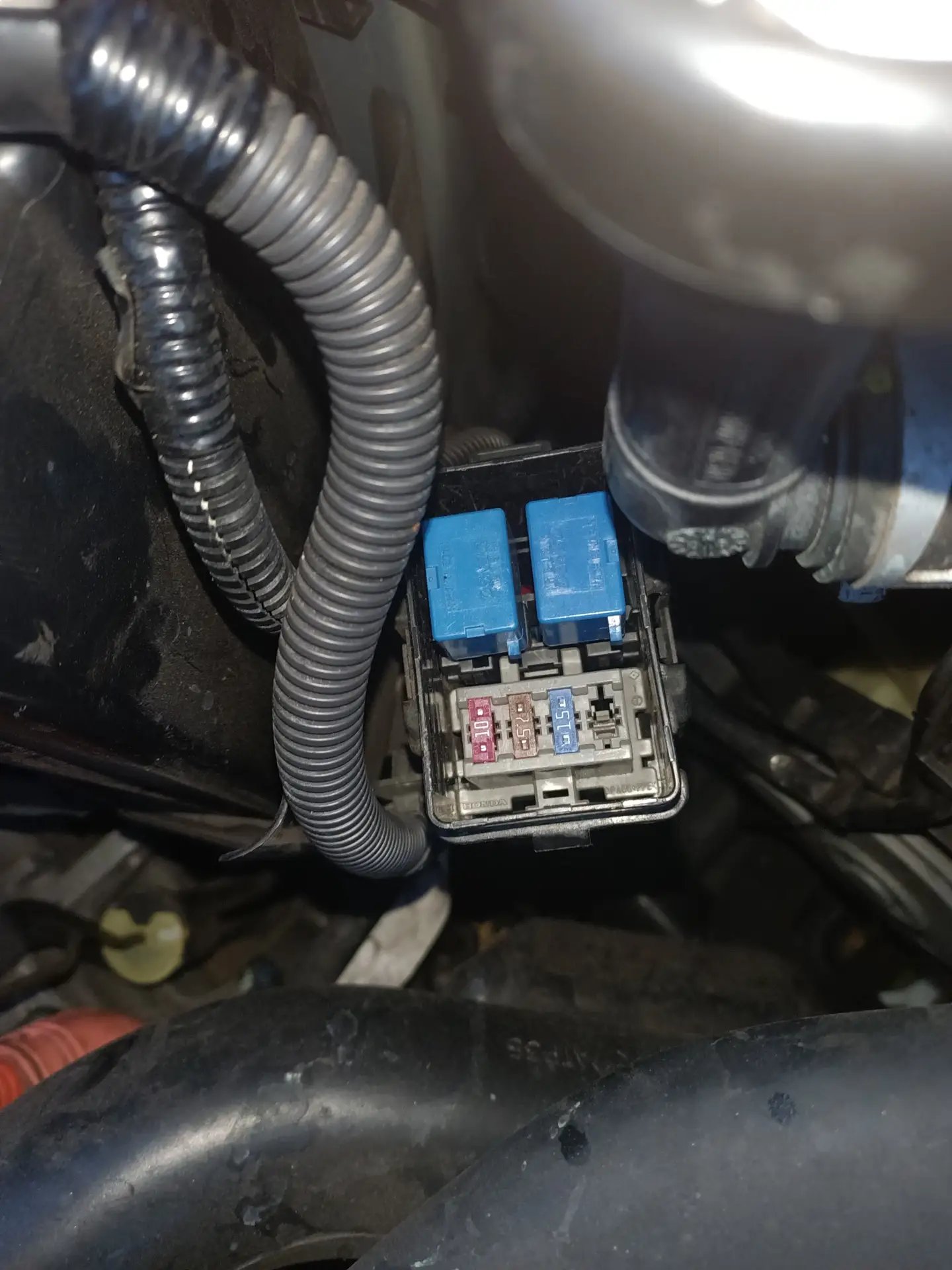

Okay. It turns out that these models have a "matchbox fuse and relay box" down below the radiator cap. It looks like this when it is healthy

mine were definitely not healthy. They were zip tied in place and sort of out of sight. They were highly corroded. I soaked them with CorrosionX and stuck in new relays. That fixed the fuel pump issue. For the future, it someone asks about fuel pump relays on a Gen 8 civic hybrid, check the "matchbox" fuse and relay box under the radiator filler and just in front of the 12v battery. The usual civic relays spots in the big fusebox under the hood and under the dash above driver's left foot are both empty and do nothing to move power to the fuel pump.
