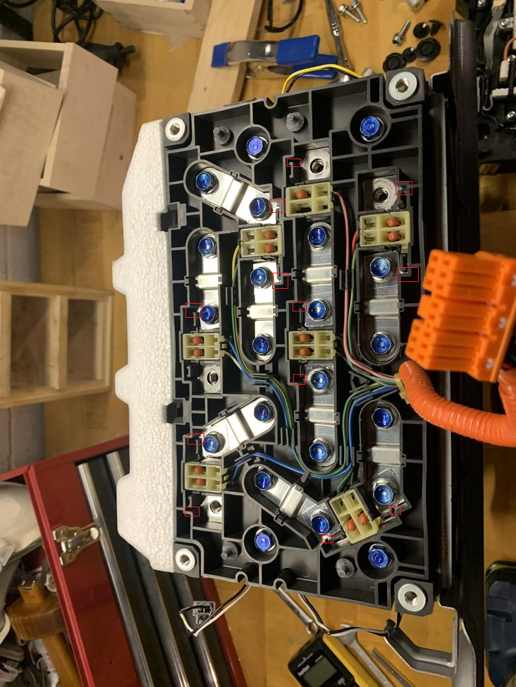

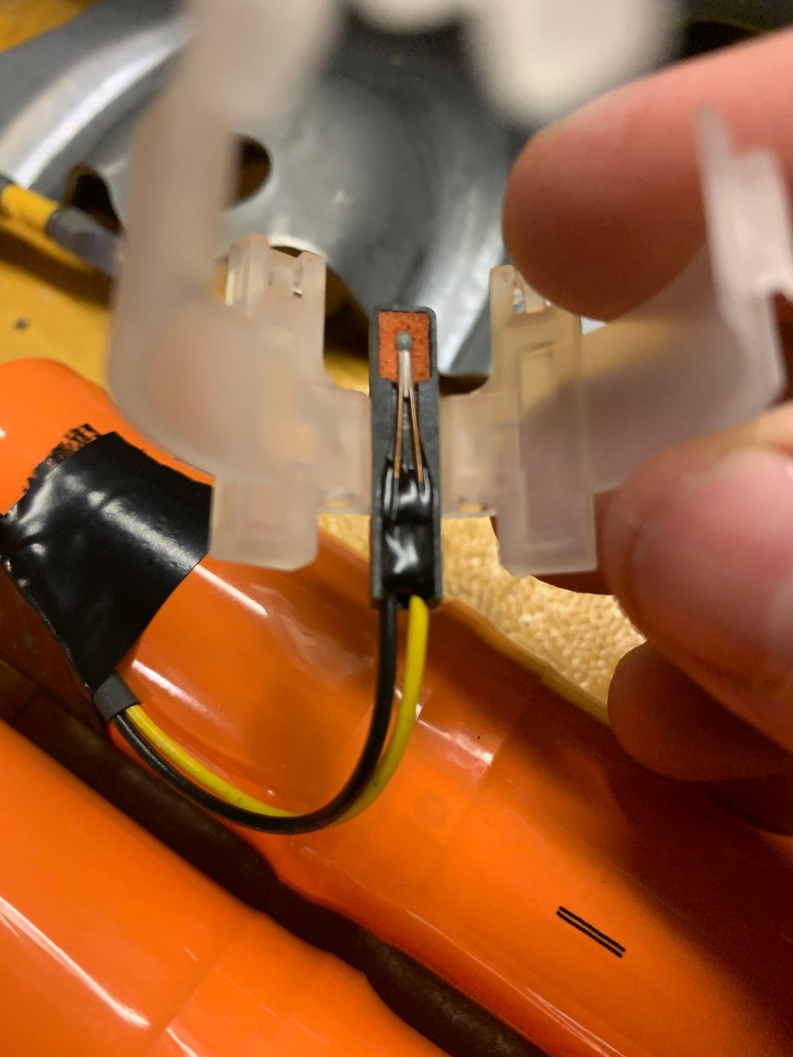

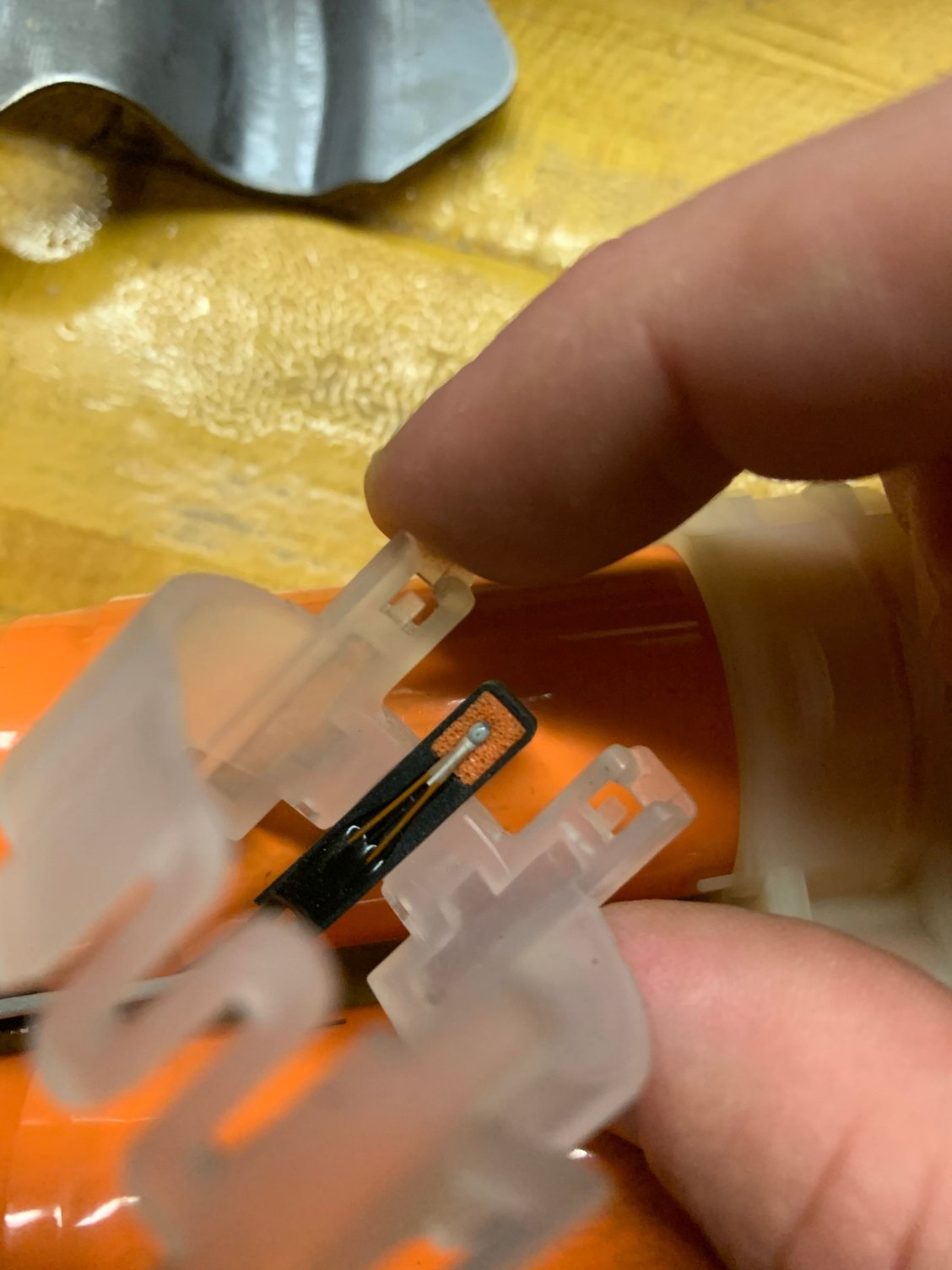

Me too, today i have resolved my problem ! The new module that i bought was good (y), The total voltage of the battery was good also, but the system was not able to read one of the modules's voltage ! One of the metal sheet was cut in two pieces.
