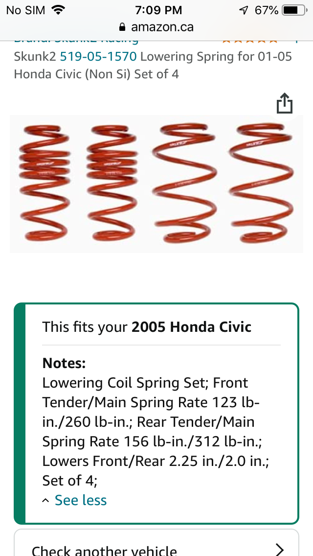

I have a 2005 Honda Civic dx coupe, I would like to put skunk2 lowering springs on my stock struts is order to have a better fit between the wheel and fender. Will I need to buy a front and rear chamber kit?
Skunk2 519-05-1570 Lowering Spring for 01-05 Honda Civic (Non Si) Set of 4 off amazon

I would highly advise to not put those on stock struts. Ride quality will be crap and you'll blow those OEM struts real quick and have to do the process again, along with another alignment. I'm not even sure Tokico blues will handle that much of a drop for very long.
Also, yes, you'll need a camber kit (regardless of strut choice) with that much of a drop, unless you wanna buy tires every 10k miles or less.
edit: Koni Yellows were the choice strut for 2"+ drops back in the day. Word of warning, they're not drop-in replacements, but inserts that you have to basically chop up and install in your OE strut to use.

It's not so much the springs, but the drop. OEM struts really can't handle much of a drop, if at all. I'd say like.. half inch or so.
Tokico Blues, they can handle up to 1.75" drop.
koni yellow inserts, I'm not sure the drop they can handle, but back in the day when ppl wanted to slam their cars on springs only or Ground Control coilover sleeves, that's the route they took.
I will say, Skunk2 has a reputation for being junk springs. I have no personal experience with them, so take that with a grain of salt.
If you're looking for an all-in-one solution to drop your car, look at full adjustable coilover assemblies, not just sleeves. That way, you'll get an assembly that has a spring rate and strut that are designed for each other. You'll spend more up front, but a lot less in the long run.
