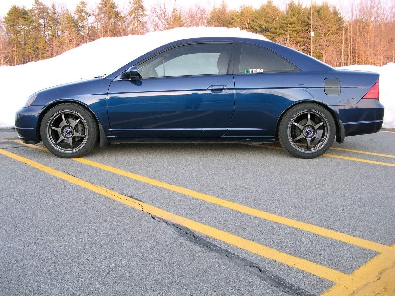

If you want some defense for winter driving.. I drove an entire upstate-NY winter dropped on tein s-techs with no issues.. So long as where you live takes care of the roads, that is..
When I lived in WA state, I also drove my lowered civic to the slopes to go snowboarding. I did have to use cable-type chains though. I did that lowered more than the s-techs, also.
tein s-techs on tokico blues is a good setup. here's what my car looked like with that setup and 17s
