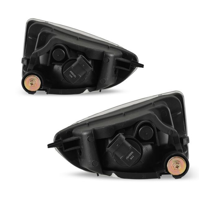

OEM with lamin-x, most likely. If you look at your OEM bumper (assuming you currently have an 04-05), you'll see little black bits where the fog lights are. You have to cut them out to fit OEM fogs.
https://www.ebay.com/c/2106569498
here's an *** end view of the fogs I linked. There's one long tab on the pointy side, that slides into that freshly cut recess, the opposite side, you can see the clip that holds it in place just north and outboard of the adjustment screw. There should be kits out there that include the wiring harness that plugs directly into the factory harness. I'll try to find the install guide for you
edit: if you want Honda OEM fogs, the kit is part number 08V31-S5D-102A
here's a post with the part number for the sub harness and switch. Alternatively, if you're savvy with electrical work, really shouldn't be hard to make one.
