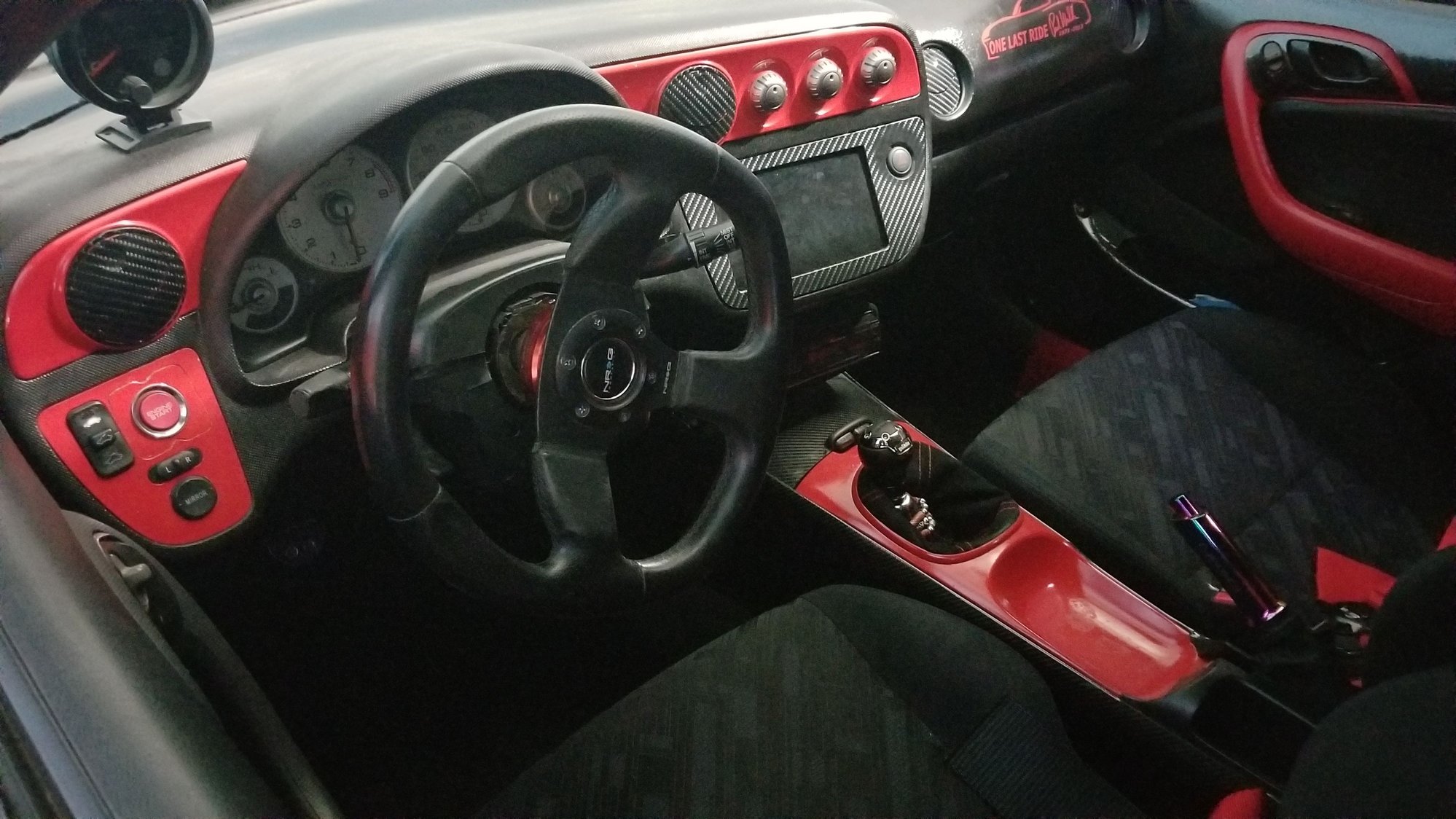

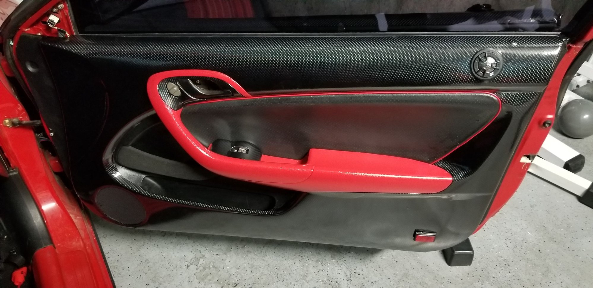

Haven't been here in years. Anyways I did this conversion, to get the rsx dash to fit you have to cut it where it meets the Windshield, same for the door panels you have to cut them as well,
As for the wiring for the climate control and the cluster you have to color match everything you will have some extra wires on both side just tape them up and put them to the side.

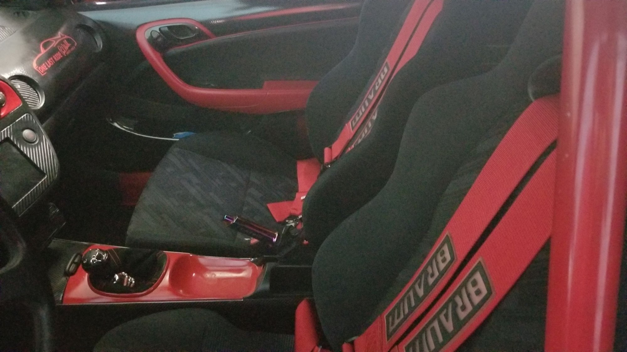

The Center Console fits without any modification.
forgot to mention when cutting the dash don't make big cuts, make small cuts and keep testing, if you cut to much it will look like crap, also you will have a space where the dash meets the cars body by the door.
And if you have the dash frame from the rsx it will make your life alot easier, I had the frame so I can't tell you how to modify the stock one.

Here you go not the best pics, I will try to take better ones later on.
