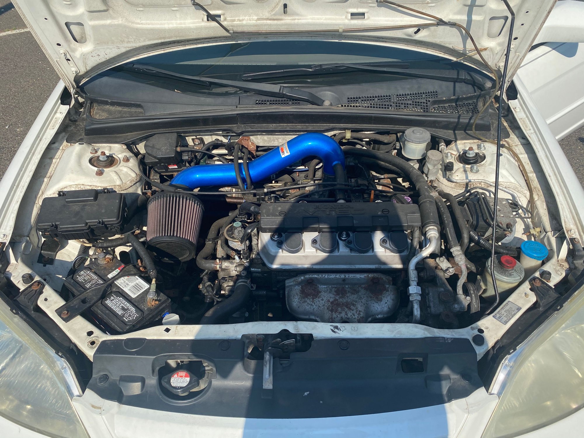

Yeah the noise stops when I push the clutch in. Also as for my endgame, I just want to improve performance in general. I'm not entirely sure how to do that, but maybe it's a better idea to do some maintenance like you guys are saying.
Edit: Heres some pictures.

Budget's another thing. You'll need a decent amount of cash to get any notable performance out of a 7th gen. Mac and Rice are the guys to talk to about that. Handling is where you can make the 7th gen shine.
Financially speaking, you're better off finding a different car if you want performance. A good turbo kit will cost in the neighbourhood of $3000, with the K-swap being roughly the same. The best bet would be something like an RSX, EP3, or Integra. If you still want a sedan, then the K24 accord is great.
You have a nice car. I'd get some suspension and a good wheel/tire setup then enjoy it for what it is: a reliable, nimble daily driver that'll still get you near 40mpg.

I had a great experience with tein coilovers (Tein SS-P) on my 2002. Started to have a small bit of failure on the top hat right before I got rid of the car 13-14 years after installing 'em. The new version of those coilovers (tein street advance) are considerably cheaper. If you don't want to go full coilover setup, Tokico HP struts and springs with a moderate drop (like.. 1.5ish at most?) are a good alternative.
Front upper strut bar is great bang for your buck. If you can find a single-piece (neuspeed was popular back in the mid 2000s) for about $100, you're solid. Might have to dig around to find ones that'll fit around the intake pipe though. It tightens up a bit of the slop in steering (mostly noticeable in quick lane change type scenarios).
RSX 19mm rear sway bar is a direct bolt on, but highly recommend you upgrade the endlinks to some beefier ones.
Camber kit to save your tires. SPC is the go-to for most people. Rear, it's an adjustable upper arm. Front, either camber plate (sometimes comes with coilovers or available from the manufacturer of the coilovers) or adjustable crash bolt. I ran the camber plates, and they were stupid easy. Loosen 4 bolts and adjust away.
