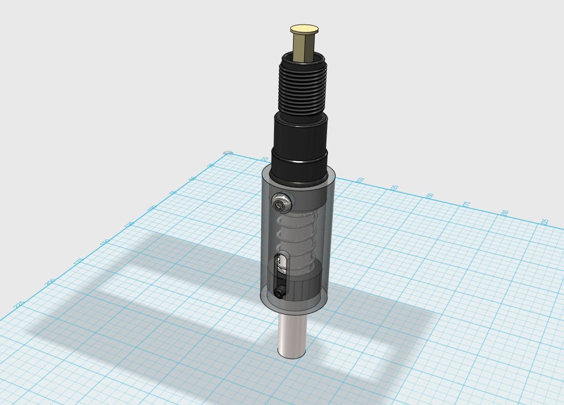

Below the adapter on the render is a spring (I'll explain why in a second), and a 14mm ID shaft collar (25mm OD). Spring sits on the shaft collar like a perch, adapter sits on the spring, **** on the adapter. **** interior activates the button shaft, able to move shift lever. Simple right? Well, not quite. You'll see that there's a translucent "sleeve" around the assembly. The way I have the sleeve designed, the channel cut out allows 0.7" travel (remember the 0.712" max travel from above?) and teh shaft collar's set screw will be changed out for a 8-12mm length set screw. . The sleeve bolts to the adapter (raceseng adapter has 4 holes for set screws) and moves with the adapter/**** and slides over the shaft collar. I have a 12" delrin tube (super slippery rugged plastic) with a 1" (25.4mm) ID coming in tomorrow so I have enough material to mess with. It was also the smallest length I could buy from McMaster-Carr. This sleeve will prevent upward travel (preventing **** removal during operation).
Josh.. why the spring? The OEM shaft should have an internal spring to push it back up....
Told you I was gonna get to that. Yes, the OEM inner shaft has a spring internal to the shift mechanism. BUT, when you're in a gear that doesn't require button depression to get out of (e.g. Neutral / S), the top of the inner shaft sits 18mm (0.712") above the top of the outer shaft. Notice the coincidence between that height and the minimum travel to be able to shift. Yep. There's a reason for that. So you can move the lever. Without pushing the button. So, why the spring? Well, if the **** is sitting on the button at it's max height, and the button drops by a quarter inch, that's a quarter inch of play, so the thing will shake and rattle like an epileptic holding maracas. That metaphor might be a bit insensitive, but it is what it is. So, when the assembly is put together, the spring will be compressed by at least 0.75" (the spring overall length is about 2"). When the inner shaft falls by that quarter inch, the external spring keeps tension on the ****, keeping it from shaking and rattling around, and retain it at the stock height for inconspicuosity. I made up that word. Inconspicuousness sounds weird. And now, proof of concept gifs.

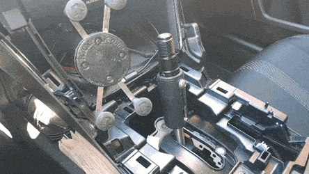

update 3: Delrin tube channel cut out and half-assed polished by wet sanding with 2000 grit sand paper. Trimmed down a bit, too. Overall travel is limited to just about 0.725" (18.42mm). All that's left is to order the shift ****. Might wait on that for a while tho. Maybe. We'll see what they have in store for their black friday sale
A few of my original measurements were a bit off. In the original render, I had the internal plunger shaft protruding about ½" above the adapter. In practice, the top of the plunger needs to be flush with the top of the adapter. Might cause some issues depending on the internal depth of the shift ****, but nothing an internal bushing or something won't fix.
Adapter in action
edit: I should note that I didn't notice any slop in the fitment. At all. It was pretty solid. In my gif, you can see I was pushing it in ways that would make any slop prevalent.
for S&G's, here's a cutaway render of the entire assembly, shift lever included. **** and sleeve made translucent because I forgot to change those colors for this picture. I'm also operating on the assumption that the adapter fully threads into the ****. Measurements for the **** were taken from Raceseng's website

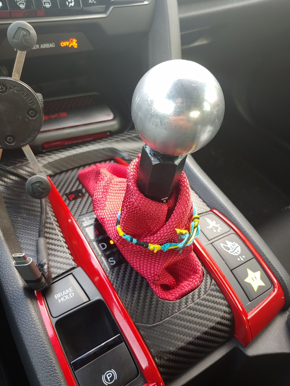

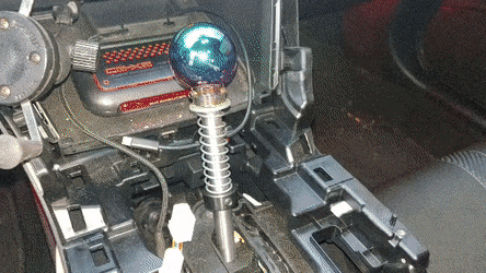

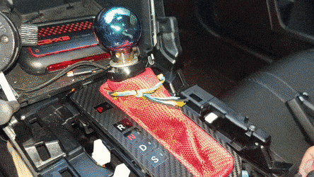

Update: got inpatient and fabbed up an adapter to temporarily fit a shift **** with an M10-1.5 thread pitch. It's a little high for my liking, but it'll do for now. Also found out that the tube I'm using has an OD (1.25) that's a hair on the big side. It fits, but it pushes the boot up and makes it all puffy. Because I'm miyuki's a fancy broad, I have a carbon fiber tube on the way. CF tube will have an OD of about 1.1" and an ID
Freshly installed
After driving some
​​​​​​if my measurements are close, top of the actual **** should sit at about the top of where the black adapter is
