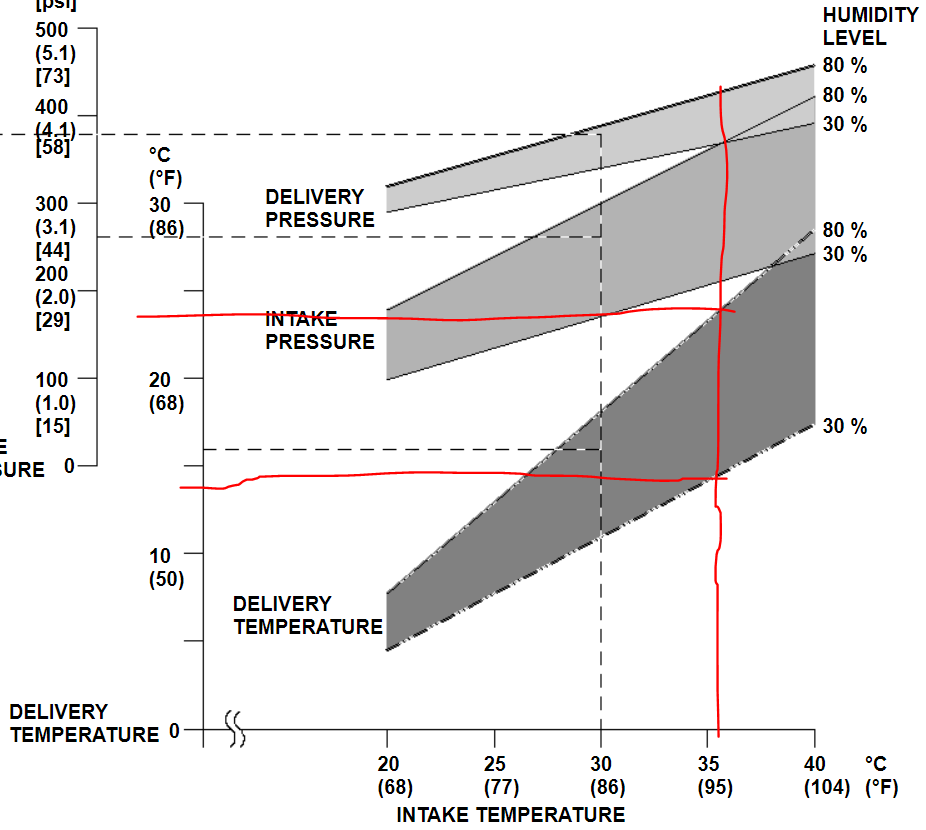

Here's a link to the A/C performance test for the 8th gen Civic, don't know what you have. It does specify some conditions that must be met during the test (hood open, doors open, engine speed above 1500, etc).
http://civic.hondafitjazz.com/A00/HT...000FEAT00.html
Output temp is also based on humidity level. The higher the humidity, the higher the output temp. Using 96F intake temp, the output temp should be between ~57-75F.
