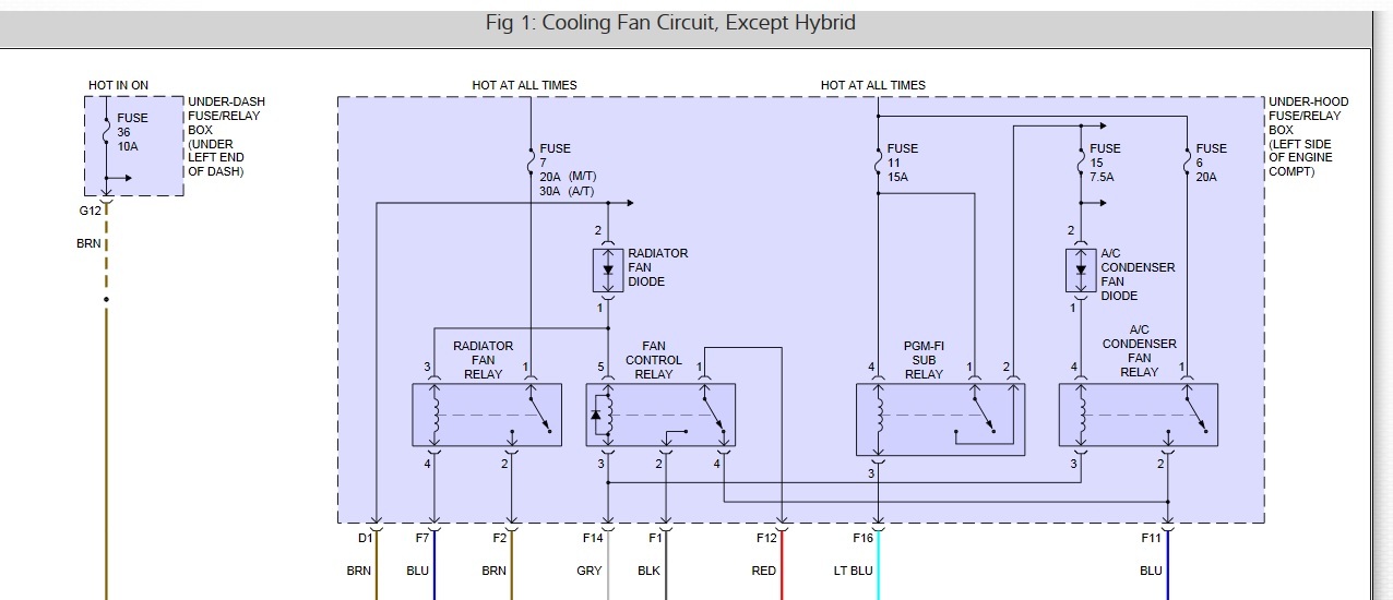

2006 Honda Civic LX 1.8 Condenser fan will not start
The A/C works fine (cold blast) on the highway but not idling (blows hot air).
Condenser fan works great if I bypass the relay. No funny noise of any kind.
I have checked all fuses with an ohmmeter and swapped all relays and diodes with the radiator fan ones to no avail. Please see attached picture.
Any help is greatly appreciated.
Thank you.
