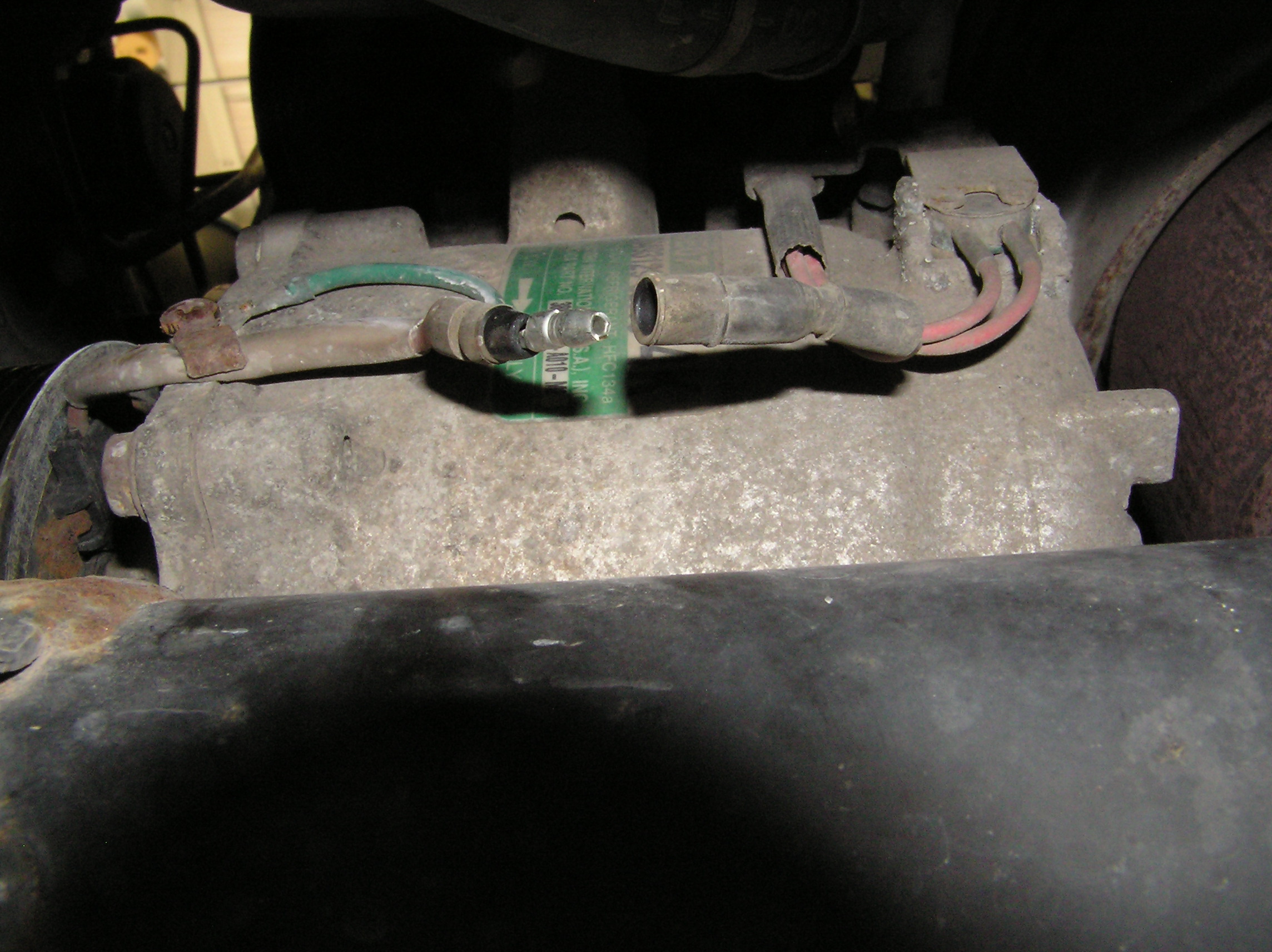

That makes it easier to condemn the coil now, just verify everything is still connected and no wires got chewed in half.
I'll try again today after work but it's a really tight fit. I could probably unplug it but I can't see myself being able to get a lead down there and reliably touching the connector.
Easiest to reach it from underneath. Take the splash shields out of the way and you can reach it pretty easy...
IF you can get under the car!
