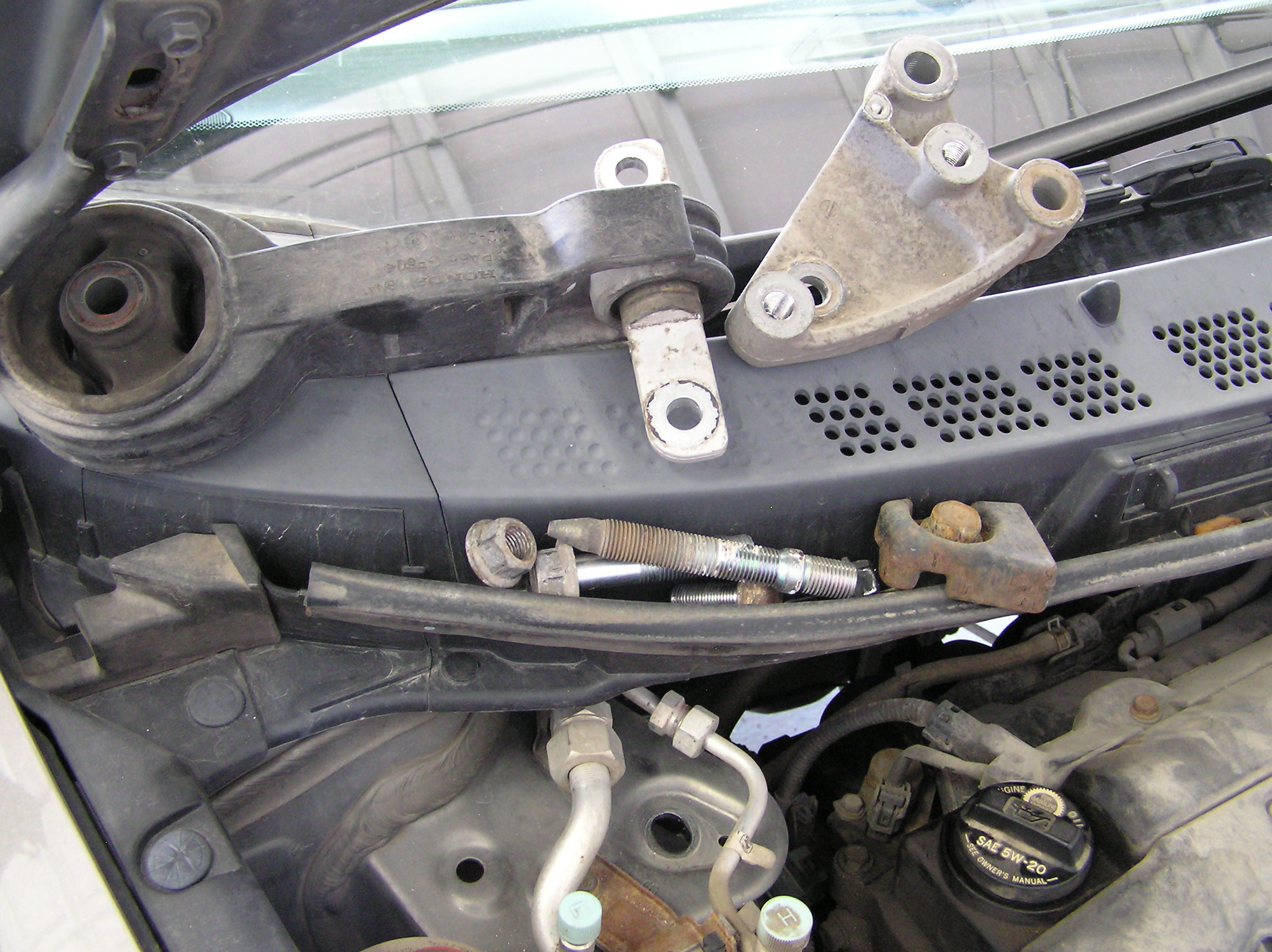

Motor mount is already taken apart because I was partway through this job when I thought to take a few pics

Take apart the motor mount (the pointy stud was not supposed to come out, no big deal) so I have some room to swing wrenches, get the belt removed, and I can jack up the engine for more room when I need to with the mount disconnected:

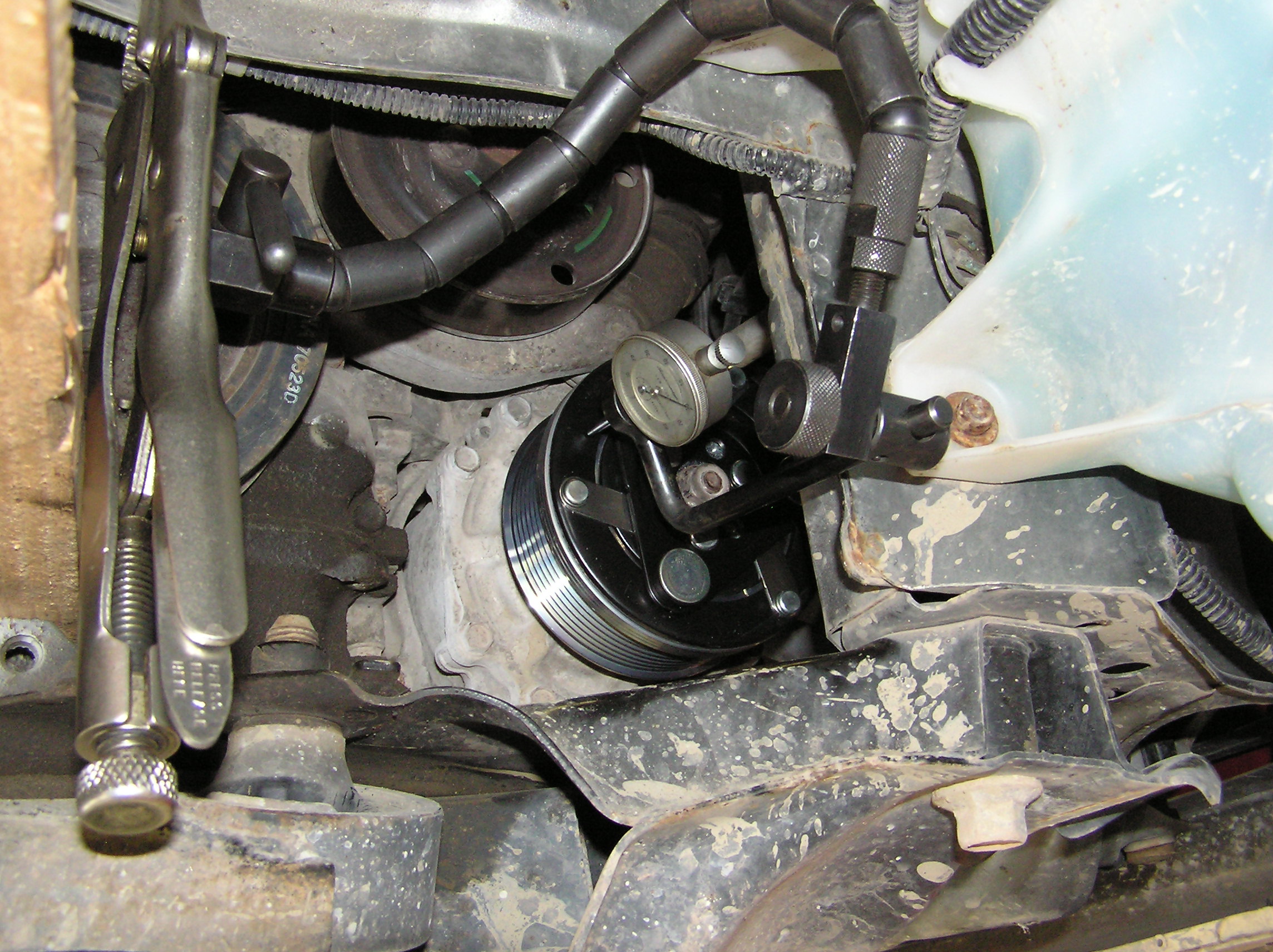

Coil installed, clutch installed, now checking and setting the clutch air gap using a dial indicator...Spec is .50mm +/- .15mm.
I did not have to touch the freon, I did not have to unbolt the compressor.
