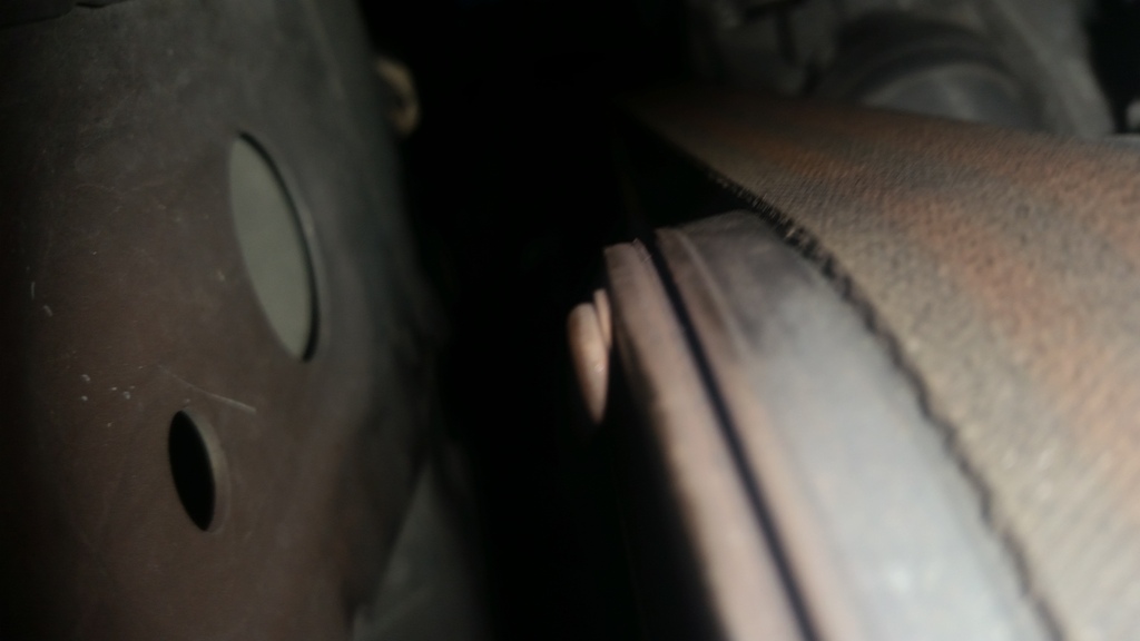

Ah ha. Good Idea. Ok, well I pushed on the plate and it didn't move. Not sure they paperclip was connected though. I will fix the paperclip and do it again. For now, here is the pick of the plate. Best I can get.

If you can't make the plate stick, the next step would be to do volt and ohm tests in the relay socket on those two terminals you have jumpered.
Remove jumper, test both slots for power.
One should have battery power.
The other will be connected to the clutch. Ohm test between that terminal and battery neg post, should have something like 3.1-3.5 ohms.
