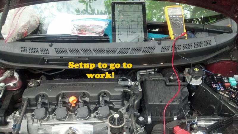

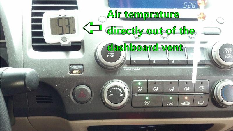

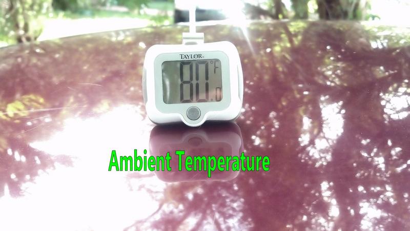

Alright everybody, I got the A/C fixed. It is 80° outside and I went for a drive, freezing my butt off. I have a really good digital thermometer that I use for deep frying, but it measures anything, instantly. I put it in the A/C vent and drove around, it went into the forties! So this thing is fixed.
What I did:
  • Gathered everything I could find on 2008 Honda Civic so far as electrical diagrams for heat and A/C, illustrations showing where everything is, text explaining how it works, and with that, a digital meter, and some daylight hours, I got it done.
  • Setup digital meter, tablet PC with all images, diagrams, and instructions. Sure beats having to print all that stuff out and you can zoom in at any point. Checked 3 wire plug to compressor. Blue/Red to ground for coil, reads 3Ω, that is good, checked Blue and Blue/White wire for thermal protector, that read like .5Ω, good again. Not the problem.
  • Pulled relay from under the hood, examined it, looks okay, swapped it with same relay from another circuit, made no difference, relay is good.
  • Checked fuse #20 under hood fuse box, 7.5 Amp. Looks good, pulled it, checked good. Put it back in firmly and compressor clutch kicked right in. I could not believe it. Let it run for quite a while, solid as a rock. Replaced fuse anyway, almost 99.9% of fuses show bad by sight or meter, every once in a while, one is intermittent of does not seat properly. These things drive you mad trying to find them, so if you even suspect such a thing, replace the fuse, it costs less than one dollar.
  • Drove around all afternoon with digital thermometer in vent, readings in the 40° zone. This is really fixed.
  • I already knew the compressor was good and the refrigerant was not low, so it left only the electrical to check and I am good at electrical, if I can get the right diagrams. Had this been the ECU or car computer, I really would have been screwed. That thing must cost over $500 and the dealer labor would have put me into bankruptcy.
Wanted to say thanks everybody for caring and offering to help. Out of three Honda forums, this is the only one where somebody did reply. I won't forget it.
Oh, I will add some pictures and the zip file of all the diagrams and help I could find for working on a 2008 Honda Civic A/C unit. Hope it helps someone. Oh crud, the zip file is too big to attache. Anyone want or need it, get it here.
