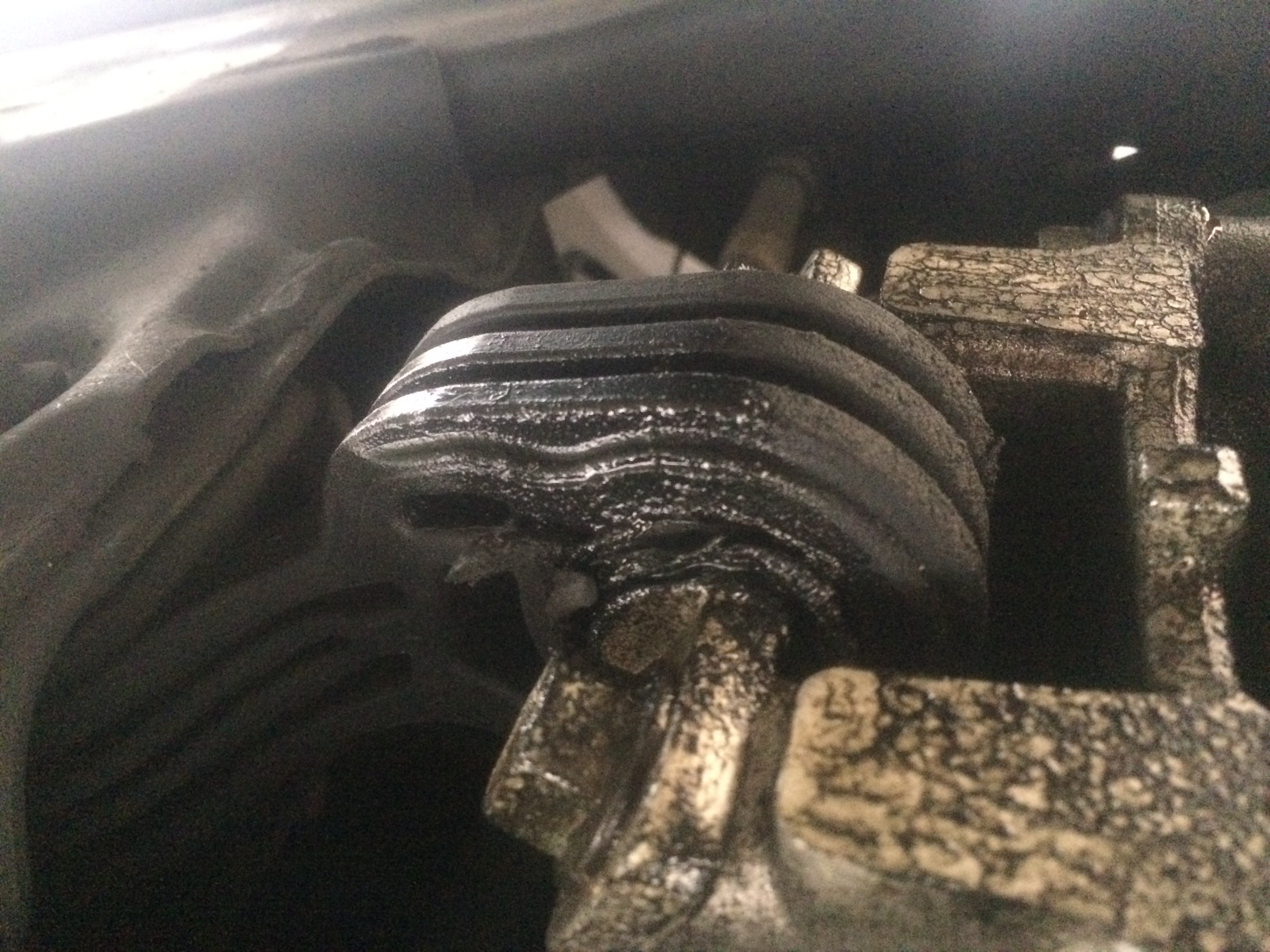

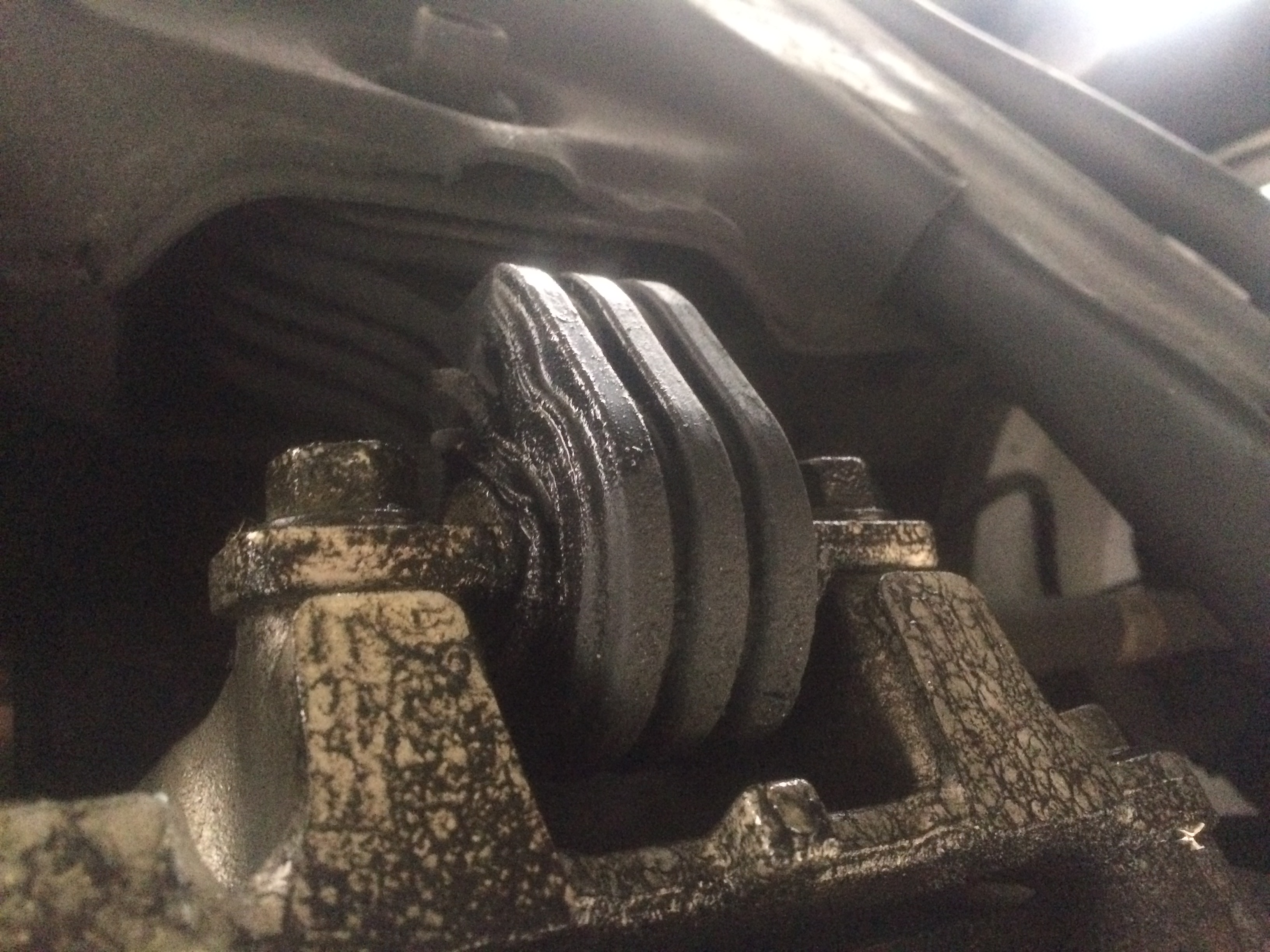

I went for inspection today and was told that 'transmission mount' is bad.
Guy showed me and it was almost next to the reasonator pipe and was accessible from underneath the car. Is it a transmission mount or some other lower mount?
Based on my description, is this the right part and location? http://www.hondapartsnow.com/genuine...0-sna-a82.html
Pict highlighted is the area I am talking about, which mount is it?
Thanks for the help.

I would not call that a trans mount, that's the engines' "torque rod, lower" in the parts catalog. Simple DIY replacement, 3 bolts and it's done. You could pull it out and look at it up close if you wanted too..
The only trans mount is on top of the trans. I've not seen one bad yet.
I've replaced plenty of engine mounts though (#6 in your catalog pic) for horribly harsh engine vibration.

Ya, 3 bolts.
Raise the front wheels off the ground...... Crawl under it with some 17mm tools and you can have it out in just a few minutes.
(I can have it out in a matter of seconds with an impact gun)
If it doesn't have enough room to slide out of the subframe, push on the oil pan to rock the engine so there's more room.
#6 is expensive
That's the one that causes the noticeable vibration complaints. There's a couple of TSBs about it for various versions of the car.

Ya, 3 bolts.
So put the car front on jack stands and use 17mm to take those bad boys out. Should I go OEM or aftermarket?

BTW, do I need to lift the oil pan with a jack/wooden piece if that mount has any stress from engine or car side or no? If not, then I'll just put the car on jack stand and will be good to go!
No lifting. The engine and trans mounts (#6 and #7) support 100% of the weight.
The drivetrain will be able to rock on those two mounts after you remove the bolts from the bottom torque rod.
The torque rod only limits how much the drivetrain can rock when a load is applied (accelerating in forward or reverse gears)...note some movement is normal and expected.

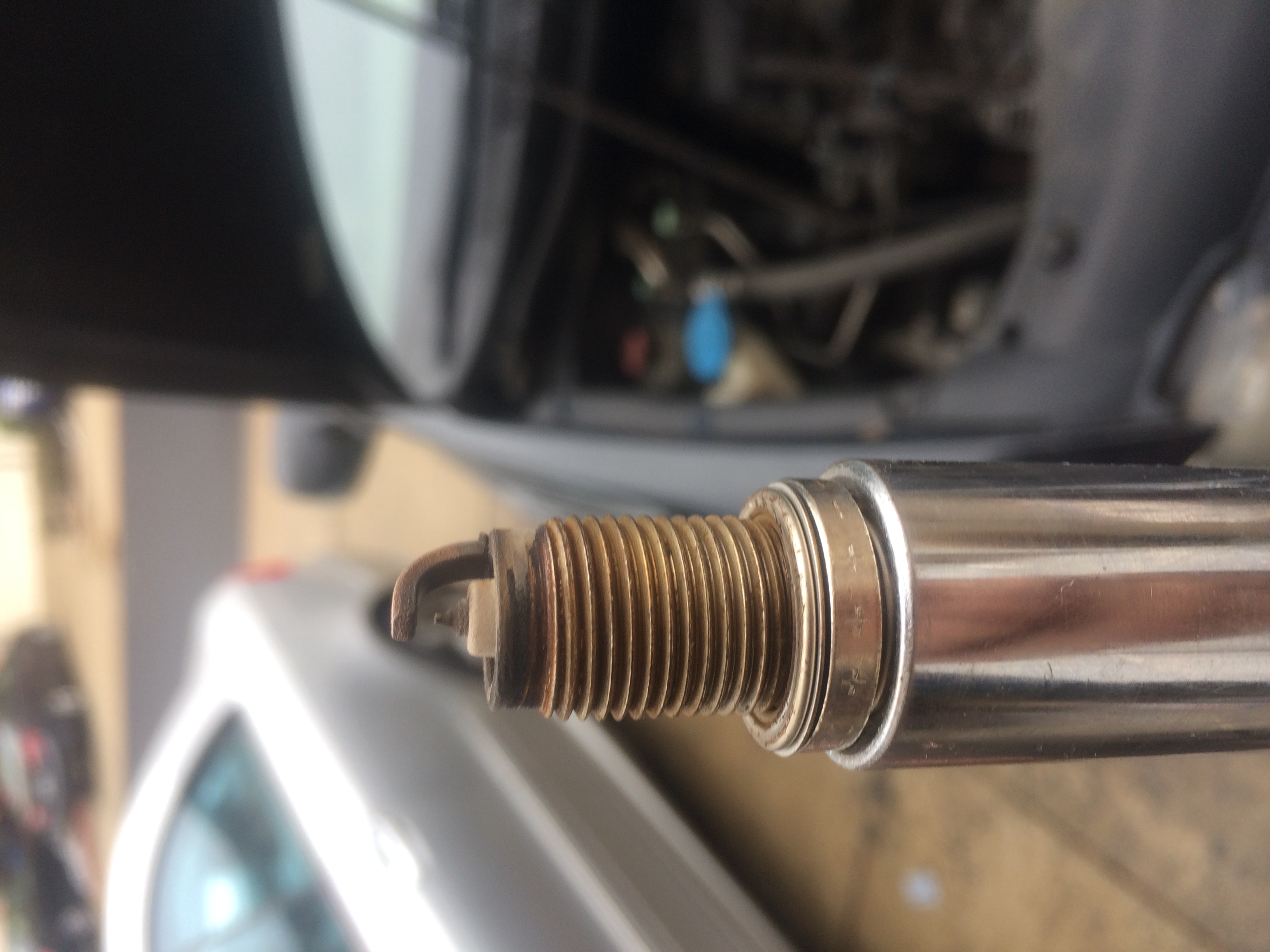

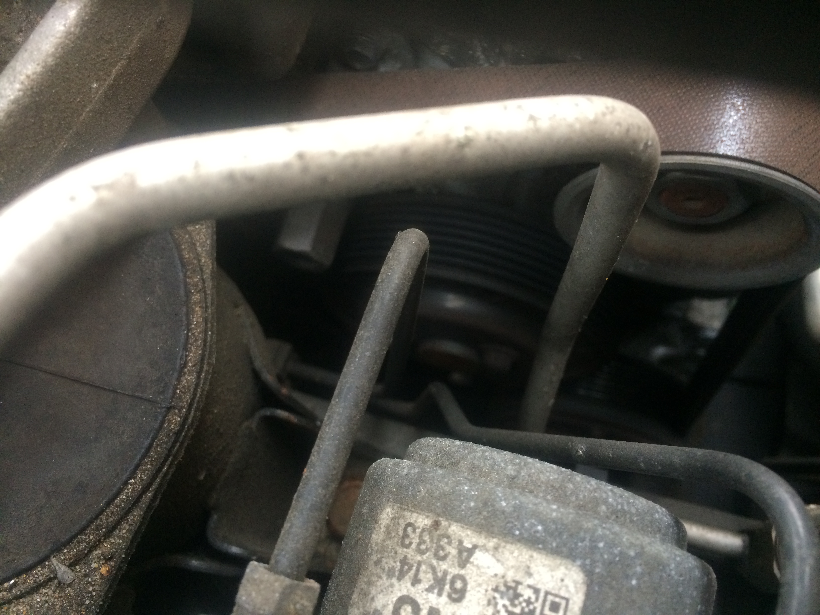

So I looked at the air filter and it looked clean and in great condition. Removed one spark plug and it was looking good too(I think), attaching picts. I am always scared about air filter, because it might cause trouble for MAF sensor?
BTW, plug price was for a pack of 4 and I thought it was cheap for Iridium ones.
Overall pict of the ribs look good for the belt too. Am I right in saying or no?
I'll take your advice, will buy OEM pads and just slap on the pads in Spring/Summer time since pads still have meat on them.
Please have a look on the pict for the Torque mount, I took a few today.

I suggest checking the items you intended to replace without checking, because I am practicing predicting the future: You would have kicked yourself for spending money you didn't need to spend.
The belt will normally turn brown as it ages. That alone does not make it bad. I still wait for cracking to appear in the teeth of the belt before suggesting replacement.
Plug looks fine to me, no appreciable wear and looks like burning ok, not fouled. I'd keep on running with them myself.
Air filter...if it's done correctly there's no issue with the MAF. Changing the filter is stupid simple, just don't screw up the clips.
I'd be more concerned with a cheapo filter causing problems, like poor gasket sealing and low quality paper element that lets more contaminants through.
I've seen a bug caught in the MAF, the engine wouldn't even run.
You have an oil leak above the mount that should be fixed.
The usual culprit is the 'oil separator cover', the black stamped steel plate up on the back of the block held on with 6 small bolts.... that just needs pulled off and resealed with fresh Hondabond. Clean off the mess from the leak too.
If you don't fix the leak, your new mount will be oil soaked and ruined again in short order.
AGAIN, why didn't the "inspector" mention the oil leak that ruined the mount?
