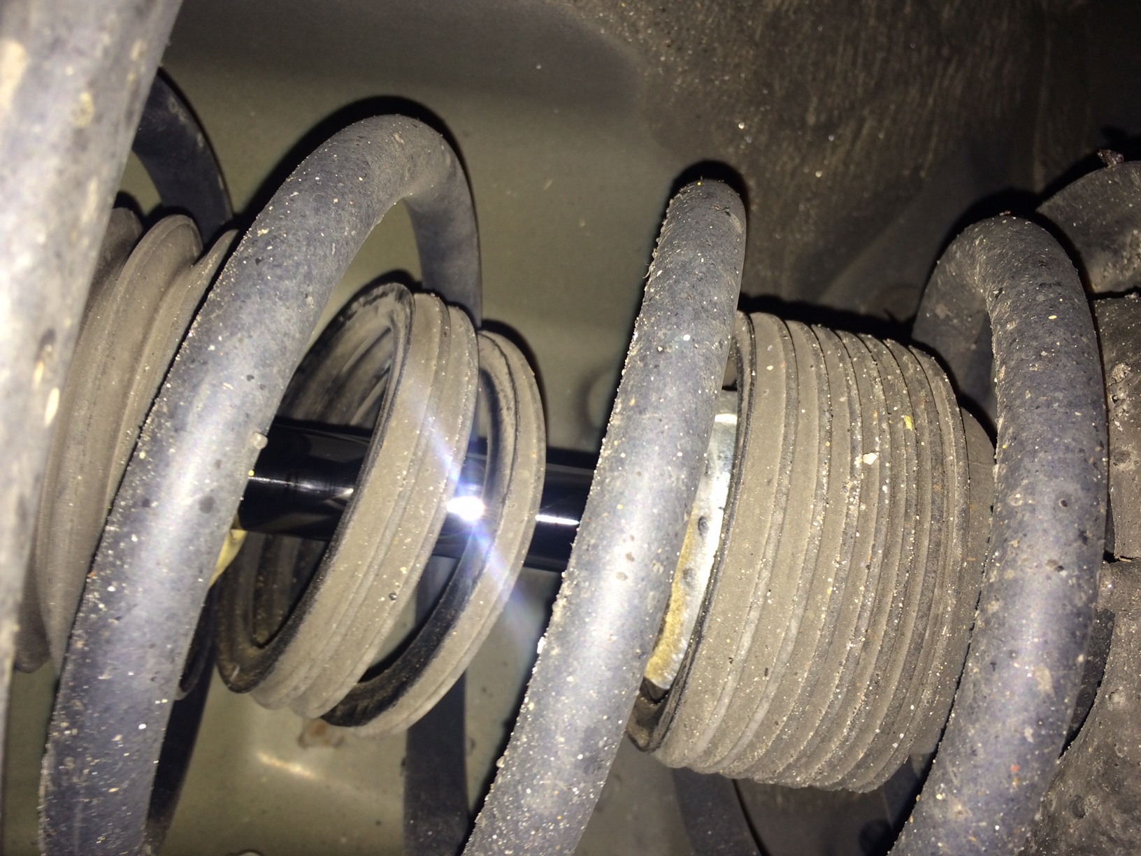

I was rotating tires and saw some of the boots on the front shocks(both sides, driver and passenger) being torn, is it normal or should I be concerned about them?
Please see picts attached.
Also, rear pads show some meat in the pict and they seem good?
Thanks for the help.

Strut dust covers falling apart is pretty typical and not cause for alarm IMO. More work than they are worth, I don't see it as a big deal, I don't try to sell them to customers.
If struts actually needed replaced, then I'd include the dust covers in the estimate.
Brakes will be needed soon. How soon? Can't tell you. Depends on how much you use them and how far you want to push it.
They need need closer inspection first: Search for the thinnest pad of the set (4). Closely inspect both of the inboard pads to see if they are thinner than the outboard pads pictured.....(they may sometimes wear at an angle , or may wear out faster than the easily seen outboard pads)... inspect, then decide.
Keep an eye on them.
A new set of pads will have the layer of friction material roughly 8mm thick. Your pads pictured might have 2mm, and that's pretty thin to me. You don't ever want to allow them to reach zero mm, that's metal to metal and gets more expensive.
I would suggest a brake job to a customer based on what I see there.

My boot's on the rear of my 07 Civic looked like that. Like ezone say, to replace them would be a pain and the OEM are not cheap. Just to act as rock shields, I got two generic boots at Oreily Auto..http://www.oreillyauto.com/site/c/de...2960&ppt=C0035 Think they were $24. I just thru away that bump stop. I split them up the side. Tore off the old ones and with the wheel hanging worked it between the spring and around the shock. I used 3 or so black tie wraps. One at top holds it on. The other two or three snug it together with about 1/4" over lap. It just hangs over the lower part of the shock. Don't attach it to it. Looks good. Protects that shaft from stone damage. Looks good. Life time warranty
I'll leave them as-is or more like ignore them.
