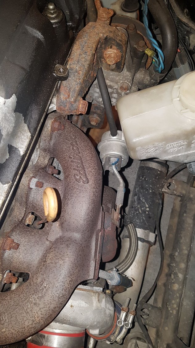

Not very clear but as you can see there is a thin steel line that runs to the wastegate if it is turned I believe it can shorten or lengthen office steel rods. Thank you for your help

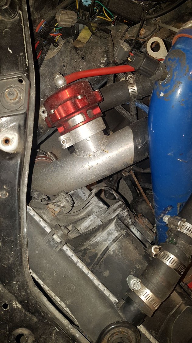

Here is the blow off valve on the intake side of things

Yep, internal wastegate, for sure. Vacuum line going to the wastegate actuator. Where's that connecting to?

Intake mani.
I have a boost gauge on the dash but not sure if it is very reliable or not it usually reads between 7 and 8 PSI when I feel fullboost is on. Which is what I believe the reviews said that this turbo would give if I'm not mistaken.

the red vacuum line runs to the mani. From the blow off valve.
