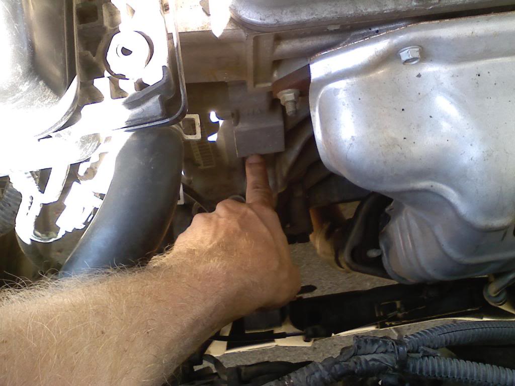

Additional info - where to find your own engine code?
this is courtesy of our good fella Lazlong - yeh, this hairy arm is not mine
stand in front of the car and look at the block between them. it should be stamped somewhere around here:
