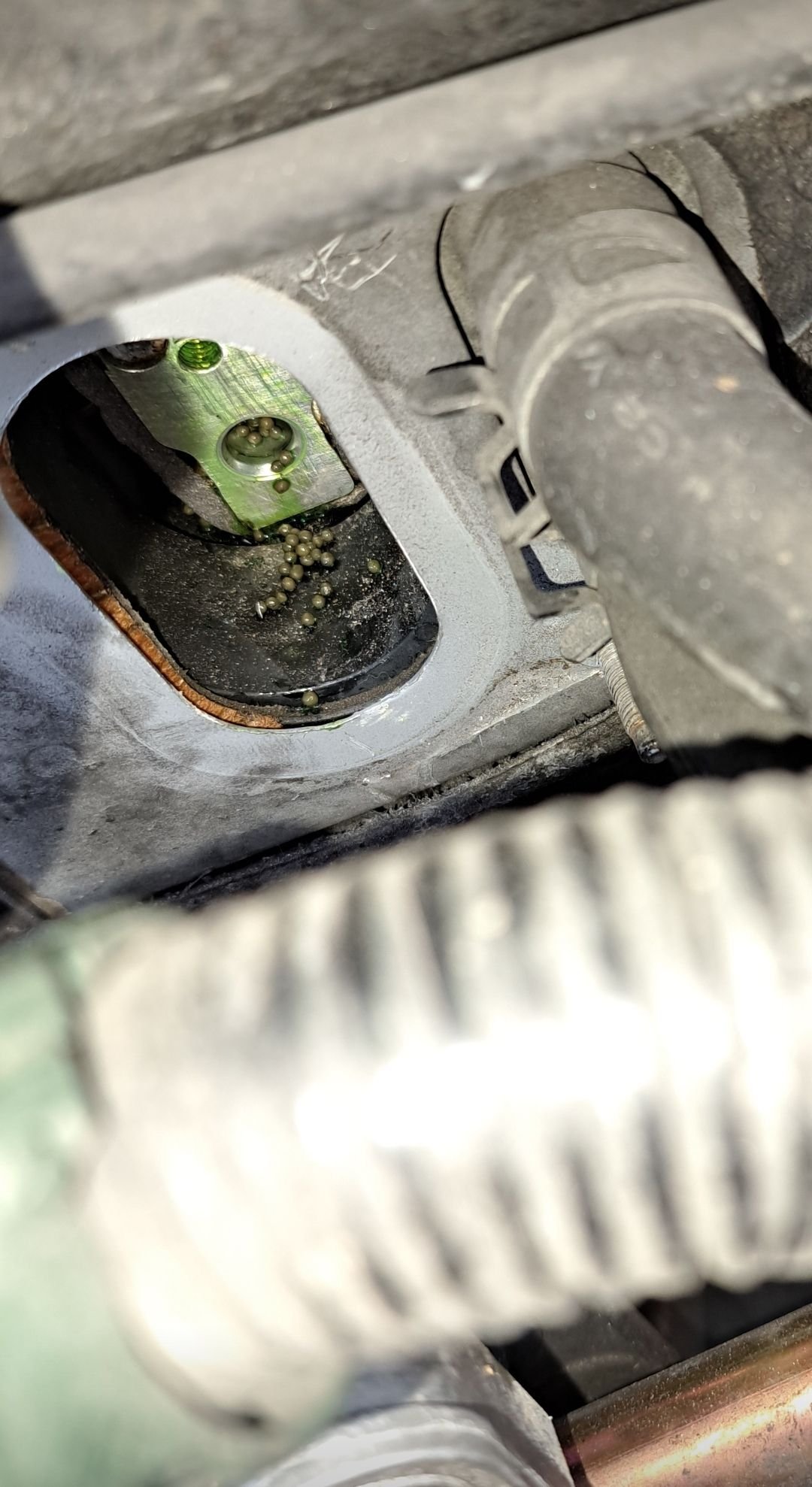

As can see in first image expansion valve, the high pipeline was clogged by those tiny round things, unsure might had came from the dryer filter or else.
Replaced mostly everything except evaporator or pipeline was good condition. The lines had pressure but was clogged in the expansion valve end. So many things to change, it doesn't end. Evaporator inside cabin was a little uncomfortable to take all the plastics out to inspect.
