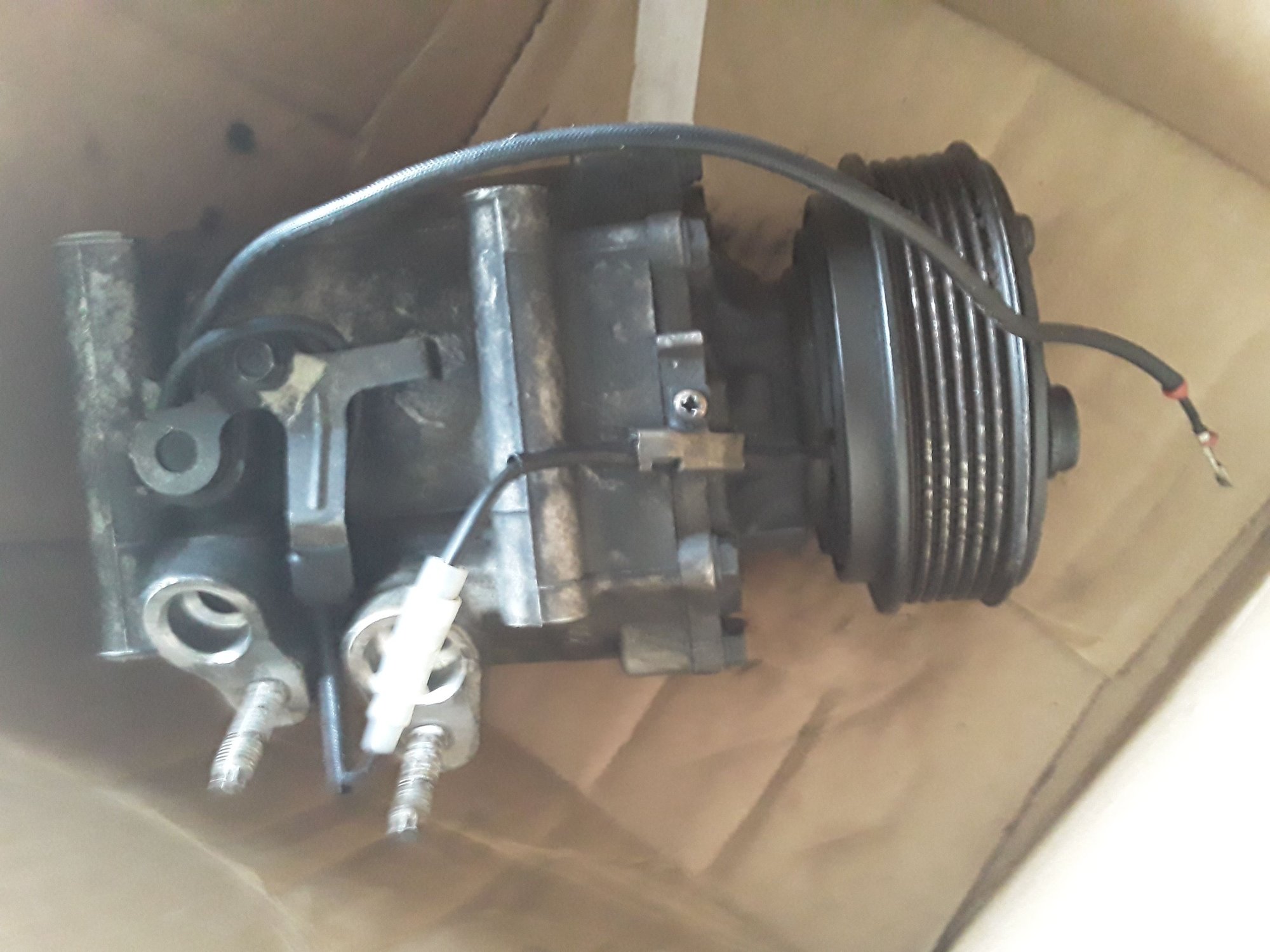

The replacement ftom salvage yard
The original one off my car.
I got a 01 Honda civic ex 2 dr 1.7, I took my compressor off to replace it, and bought another one from a salvage yard. The wiring is different from the one that came off my car, the replacement I bought has only 1 wire going to the clutch and the one that came off my car has 2 wires going to the clutch, my question is will it still work?

Should be fine, but definitely energize the clutch before you install it and observe it “snaps” in when powered up.

bought a new one, but the studs aren't in the new compressor to bolt the ac lines back on to the compressor, was wondering what size bolt I would need to just bolt them back on instead of using the studs and nuts.

I believe they are an M6-1.00 bolt. I can get you the size and length when I get home this evening (as long as I don't forget).

M6-1.00 bolts, something like 25 mm in length should work just fine.
