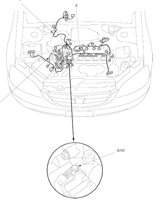

Re: My civic
So I checked that fuse and it is good what else can it be I am starting to think the ecu went or is bad and I can’t find one for a ex 5 speed

Fuse 20 in the under-hood box? G101? Do you have a multi-meter? Verify those fuse actually have battery voltage when the key is on. Verify G101 has continuity to the negative terminal on the battery. How are you testing for spark? Did you check the alternator bolts on the bottom (alternator to bracket and bracket to block, both need to be clean and tight). The fact that you can't get a scanner to connect still points towards a bad ground. Do you hear the fuel pump priming when you first turn the key on? Should run for 2 seconds.

fuel pump primes all the grounds where clean alternator bolts are all clean and tight everything thing else needed is good just no spark and I don’t think all four coils can go bad at the same time

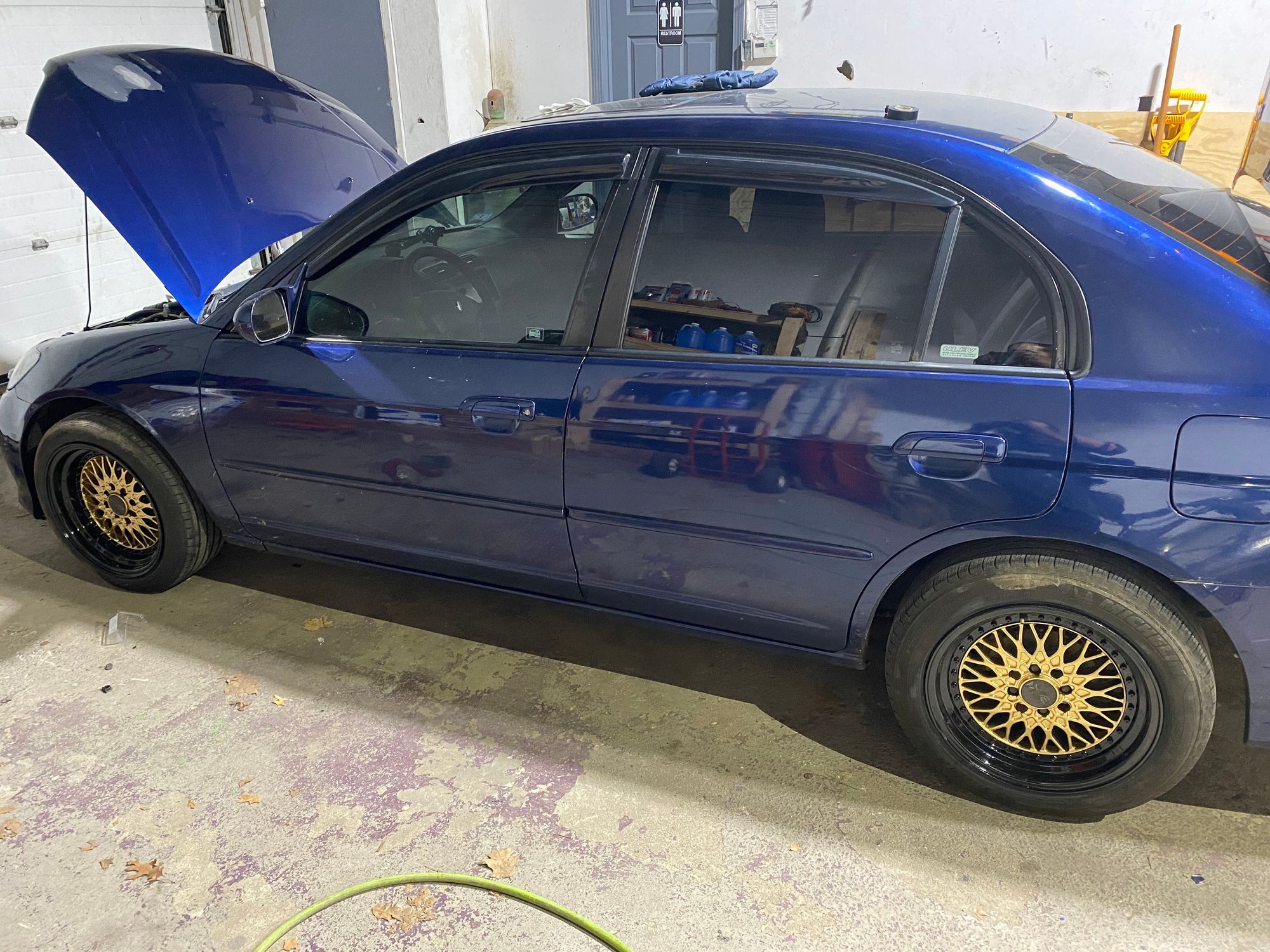

the car picture does not tell anything about your problem...
