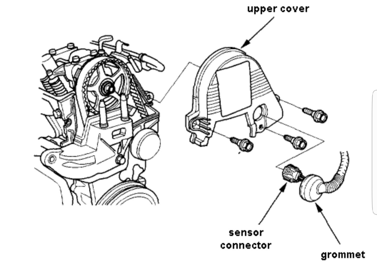

It's pretty simple but it's time consuming just to check the timing marks.
you'll have to remove the valve cover (you can use this video https://youtu.be/XkkWhrr9kAo)
then you'll have to remove the upper timing belt cover (pic 1)
then you'll have to jack up the car, remove driver side wheel.

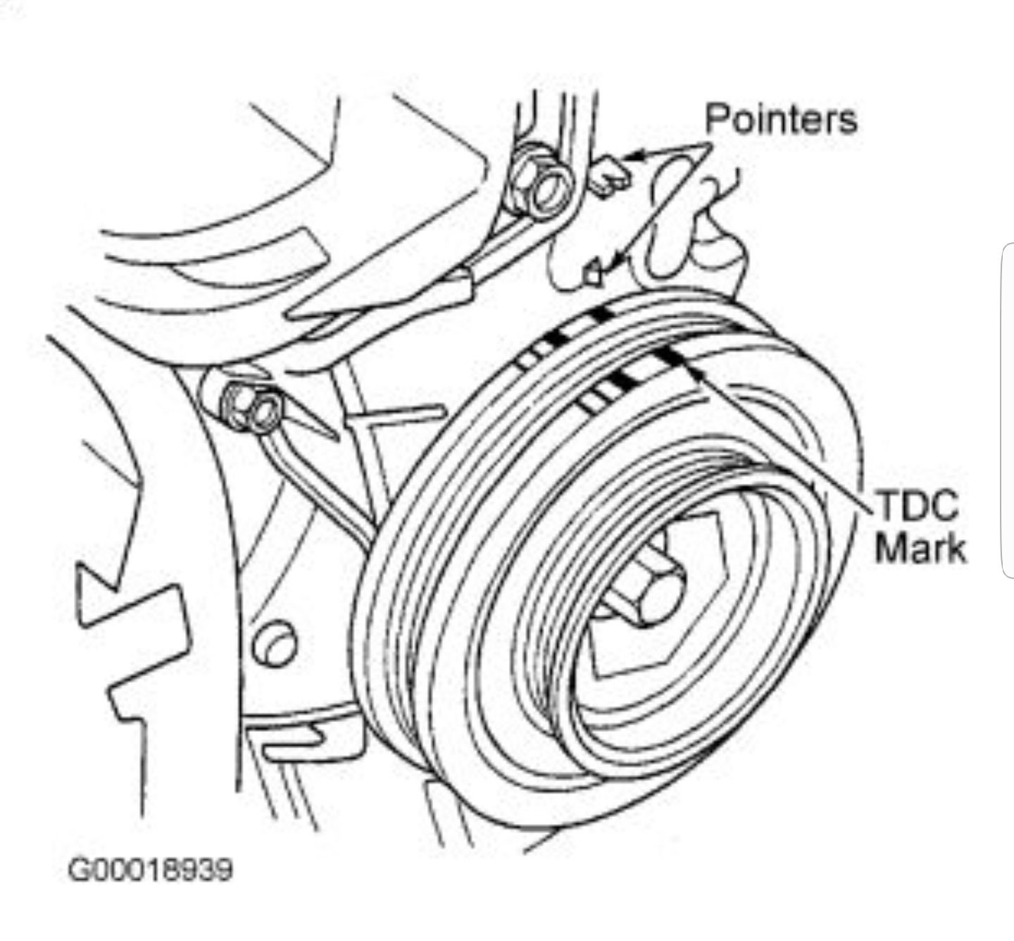

there's a spot on the wheel well cover where you can stick a 19mm socket straight to the crank bolt.
spin the crank (counterclockwise like if your trying to remove the bolt) make sure the camshaft markings are line up
look from the top at the crank pointers and make sure those are lined up too.
last week my car timing belts jumped a tooth, and it wouldn't start just like what you're describing
ah, the dreaded valve cover removal lol. that's really good info though, thanks again for the help! I'll have to crack open the engine this weekend. just out of curiosity, did you notice if you had a no spark issue before you checked the timing?
