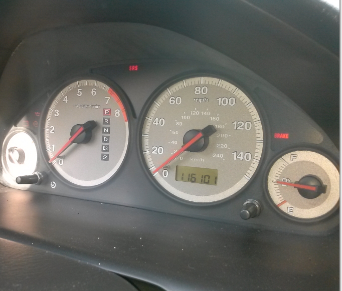

Hi. Sorry for another question, my searches have not helped me much.
Basically I just changed the battery after it died and was not being used for some days waiting on a part.
The new battery seems ok, but the car won't start. Googling around I found stuff on "valet" mode, anti-theft mode, and some routines that involve either codes or simple manual tricks to start it, but not much clear info to me.
I only have a beeping red light above the dash, some user suggested that I have an alarm put in by the dealer, with a fob that looks like this:
The key turns, and the light all seem to work, and the radio (not orginal but and aftermarket stereo) seem fine, but there simply isn't a start. Only the alarm goes off when I close the door somewhat hard, but the keys in the fob don't work (they used to work), so I put in a new CR2025 battery in the fob (last one died out), but the keys don't work.
Frankly I don't mind having no alarm, but would appreciate any tips on how to start it.

Thank you! I went through there before asking.
No key symbol flashing, and I doubt it would be the starter since the car was working perfectly fine until the battery drained completely because of this: https://www.civicforums.com/forums/1...ts-always.html
I tried to jump start it (read I shouldn't do this after), and then just went ahead for a new battery.
Now when I turn the key on II, I seem to have a working battery, the regular signs that I was used to see show up:
But I hear a weird sound, as if it was trying to do or find something. I recorded it here:
[code]http://vocaroo.com/i/s0Y2sImdmwUA[/code]
It happens after I turn the key into II, after second 0:06. It's quiet, but it sound like a soft mechanical sound struggling... After going back to I, and back to II again, that sound never appeared again.
When I turn to III, there are no sounds at all, not even from the engine.

Sorry for late response.
No, there is no crank on III, or any sounds from the starter.
The lights on the dash remain lit on III and back to II.

You probably have a simple wiring or starter issue then.
First suspect is battery cables.
Do you have any non-original cable ends
These suck. The cables come loose and may not be able to carry power when loaded. Or only one of the cables might have a bad connection once in a while, causing much hair pulling. Or corrosion left over from the original failure finally eats its way and causes a bad connection.
Same goes for those gold colored cable ends that all the cool kids put on to go with their amps and subs.
Figuring out why it won't crank is really a matter of knowing that particular system, and some checks that I might do with a plain old light bulb type test light. Starter must have 2 hots and ground during operation. You, a test light and a helper could have that much checked in 30 seconds.
I did not check this article, but it looked pretty: http://easyautodiagnostics.com/bad_s...ar_tests_1.php

Re: Car in anti-theft/ immobilizer mode, won't start?
Correct, the green key symbol only flashes after I turn off with the key, but doesn't appear when I crank it.
The battery fuse (80A) doesn't seem to be bad either since the lights on the dash don't appear at all before or after cranking it if I remove it (just to show how little I know about all this beyond just changing oil, spark plugs, air filter, and little maintenance stuff).
Battery cables are original, but look pretty clean with no rust or corrosion on them.
The high beam, and all lights seem to work fine with the new battery, and they don't dim down or anything unusual.
I have yet to test the starter since I'm scared of doing something wrong, seeing how it's a common culprit in these cases (bad connections TO the starter as well) after watching some videos. This one mechanic fixed it by just tapping the starter with a hammer a bit, but I don't want to do stuff like that and take my time going through all possibilities (having no garage and short time at night to work on this is a bummer).
