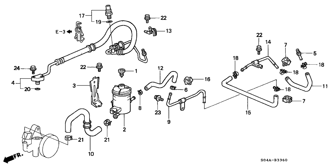

Hi folks I noticed by steering was very hard to turn and the ps reservoir was empty. Also noticed a leak under the car. Its coming from the middle of car. Its leaking from a steel line that goes into the rack n pinion. But for the life of me cannot see where it goes to. The rack on both sides is dry and is dry under the ps reservoir. Any idea about this steel line? It looks like a big job to replace it. Thanks Kindly Happy New Year.

It will either go to the pump or the reservoir. Not the most fun job in the world but way cheaper to do it yourself rather than paying someone. There's probably a video on YouTube

https://www.hondapartsnow.com/resour...a66239b17d.png
Is that leaking part shown in this diagram?
