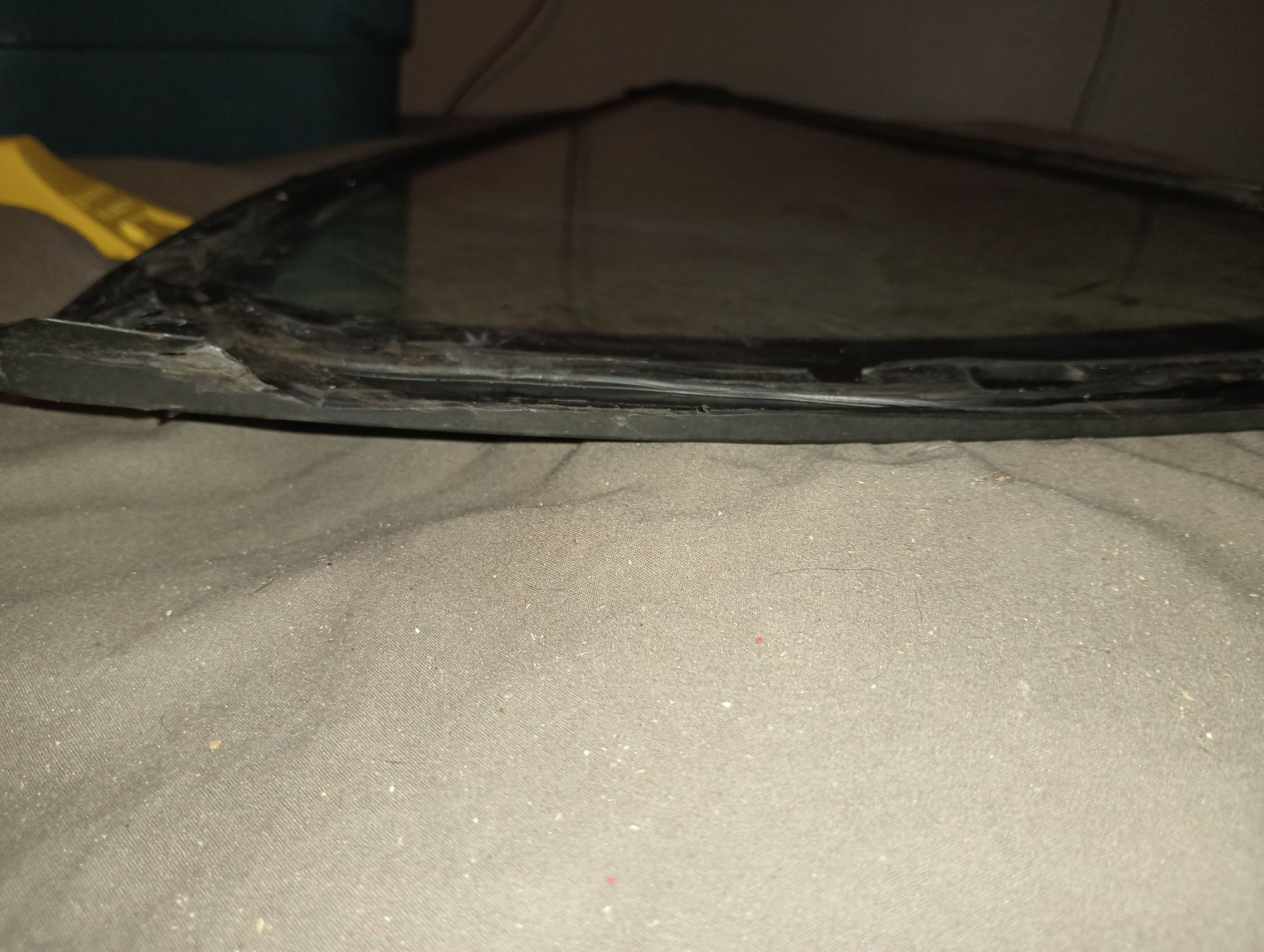

My question is how important is the piece of trim on the front portion of the window you know the part that kind of hugs the contour of the car body I mean I guess it acts like a shield because there's caulking behind it but I couldn't help but damage that portion a little bit does anyone know what I'm talking about? I'll try to get a picture uploaded

I'll need a photo. If it's the one I'm thinking of, it's fairly important.

have no idea what you are talking about, don't remember anything like that on 96-00 cars.(you did post on the 6th gen section, so supposing you are talking about this gen?)
