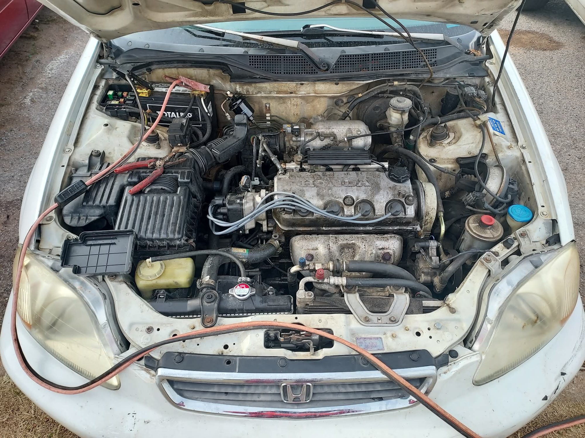

I'm working on a friends '97 Honda Civic. It has a crank no start condition.
He's replaced the fuel pump and filter on his own. I've verified fuel is making it to the engine by removing the fuel rail and injectors and cranking the motor with the key...fuel is spraying out of all injectors.
His spark plug wires were welded/corroded to the spark plugs, but the spark plugs didn't look too bad, other than what looked like burnt oil on them.
We replaced the spark plug wires and spark plugs and verified spark using my inline spark plug tester at all 4 wires.
No vacuum leaks indicated with a smoke test.
We have fuel, spark, and vacuum, but still crank and no start.

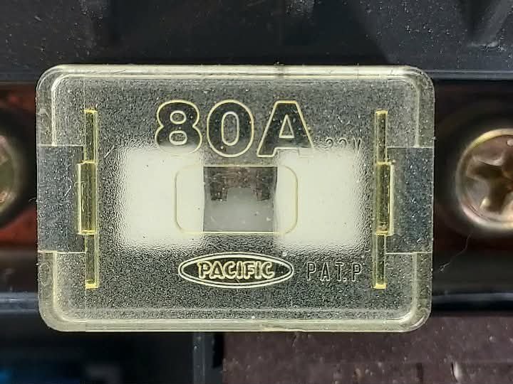

The next thing I checked was the fuses. I checked all fuses under the driver's side dash related to ignition and starting, none were blown.

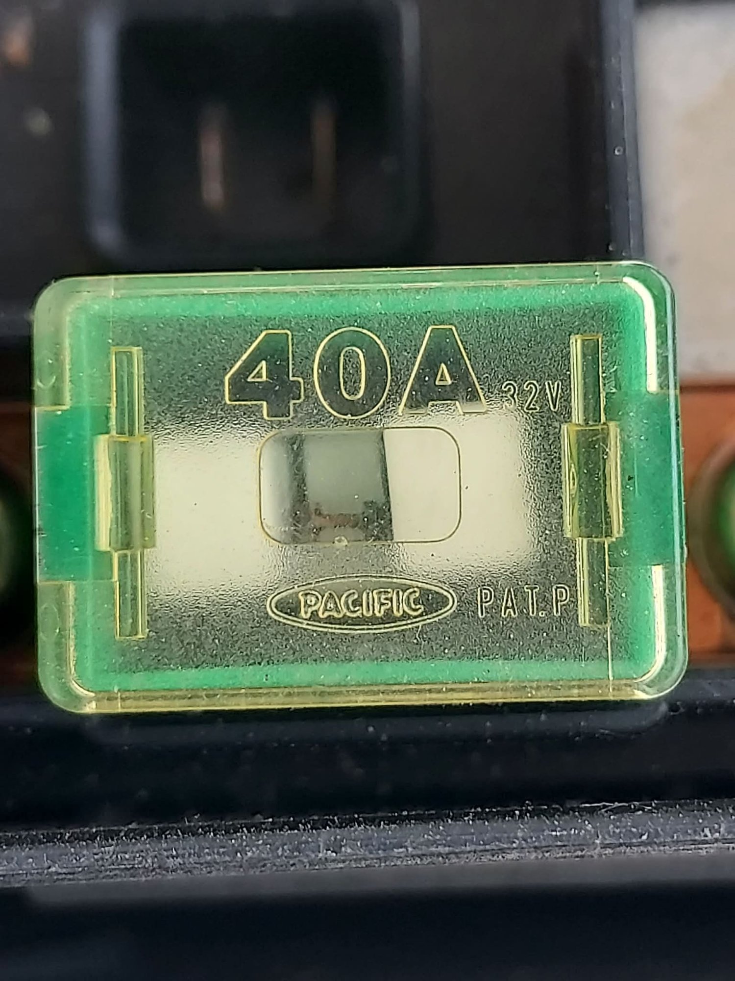

I checked the fuses under the hood, and I'm unsure of the bigger 40A and 80A fuses. The 40A fuse is an ignition fuse.
If this fuse isn't bad, I'm moving on to checking for a bad sensor/sensors...
Which sensors would be bad and cause a crank no start condition with fuel, spark, and vacuum being verified ?
If not the sensors, what else could I look at ?

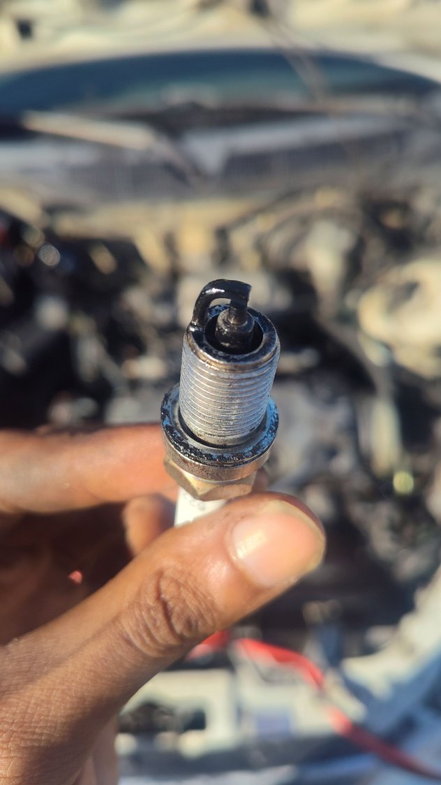

Spark plugs were Autolite brand, and I just took them straight from the box and installed them. Not sure if they came pre-gapped... What should the gap be on the spark plugs ?

No idea what the gap is supposed to be, check the sticker under the hood or the owners manual.
should only use ngk plugs on a honda, but they should be better than what was in there

The spark plug gap for a 1.6 L is 0.044".
Upon looking at my compression gauge, the hose looks to be long enough to thread into the spark plug holes.

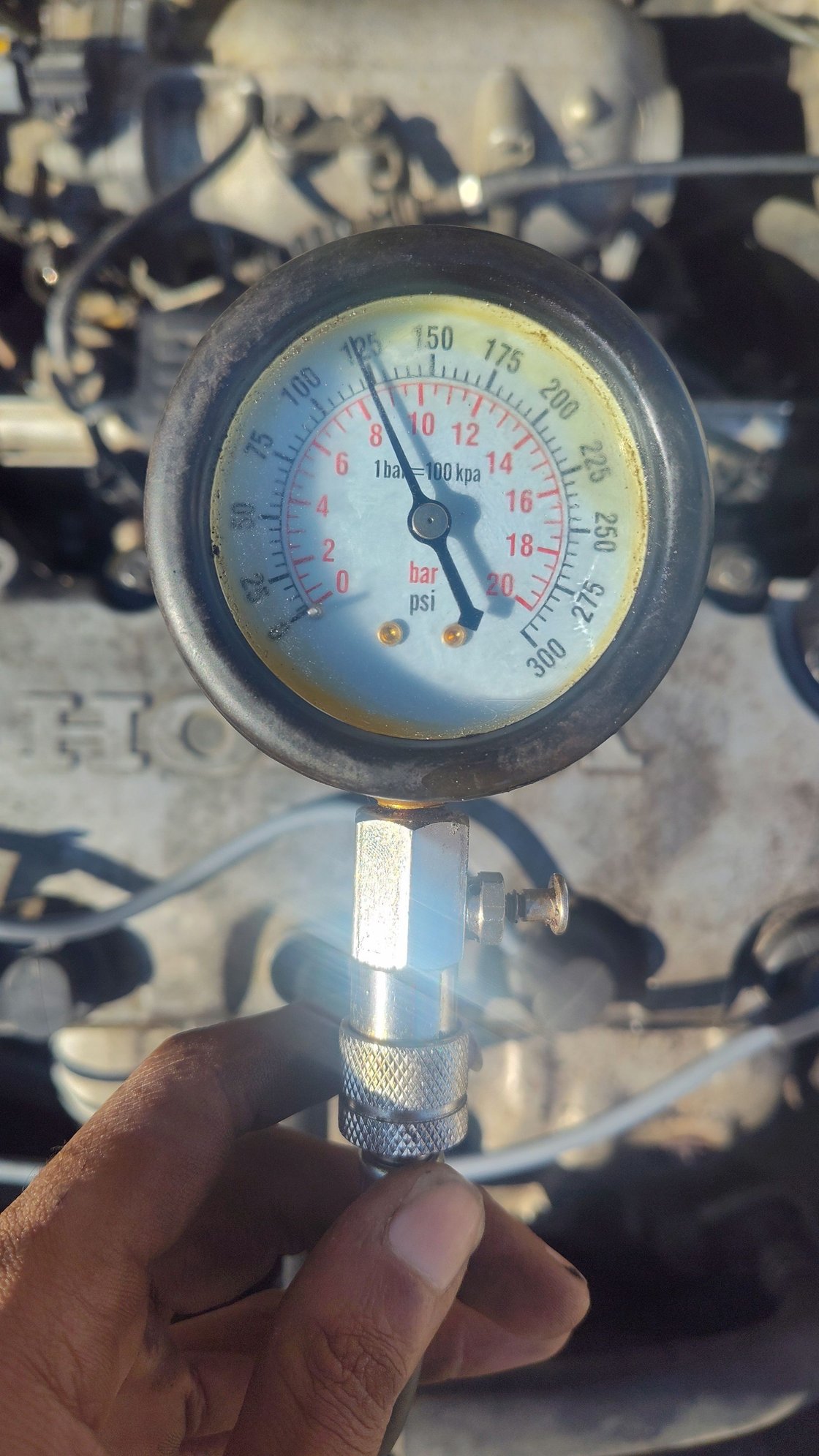

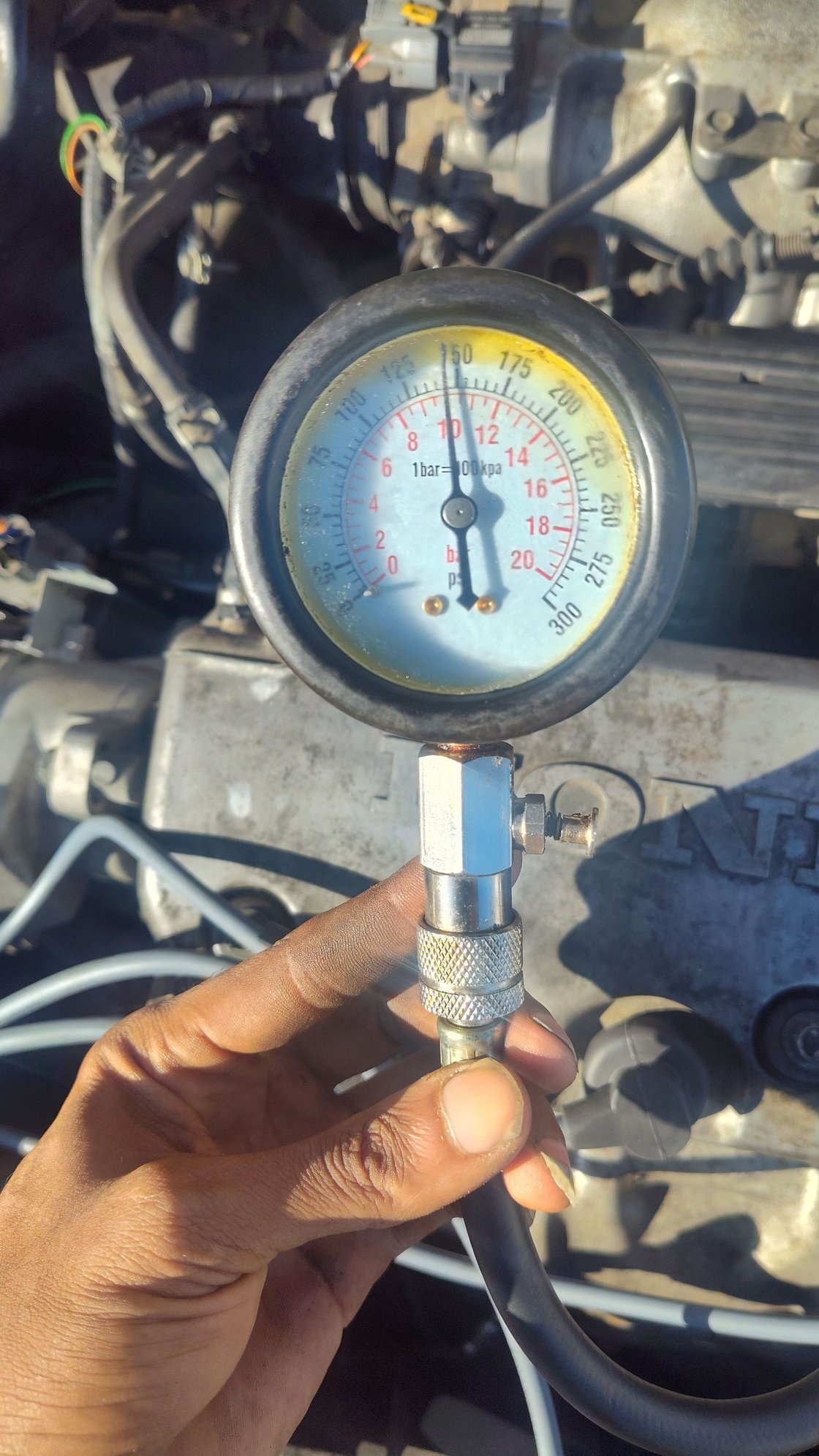

Compression Test Results
Cylinder 1 - 130 PSI
Cylinder 2 - 145 PSI (Oil on the new spark plug)
Cylinder 3 - 120-125 PSI
Cylinder 4 - 175 PSI

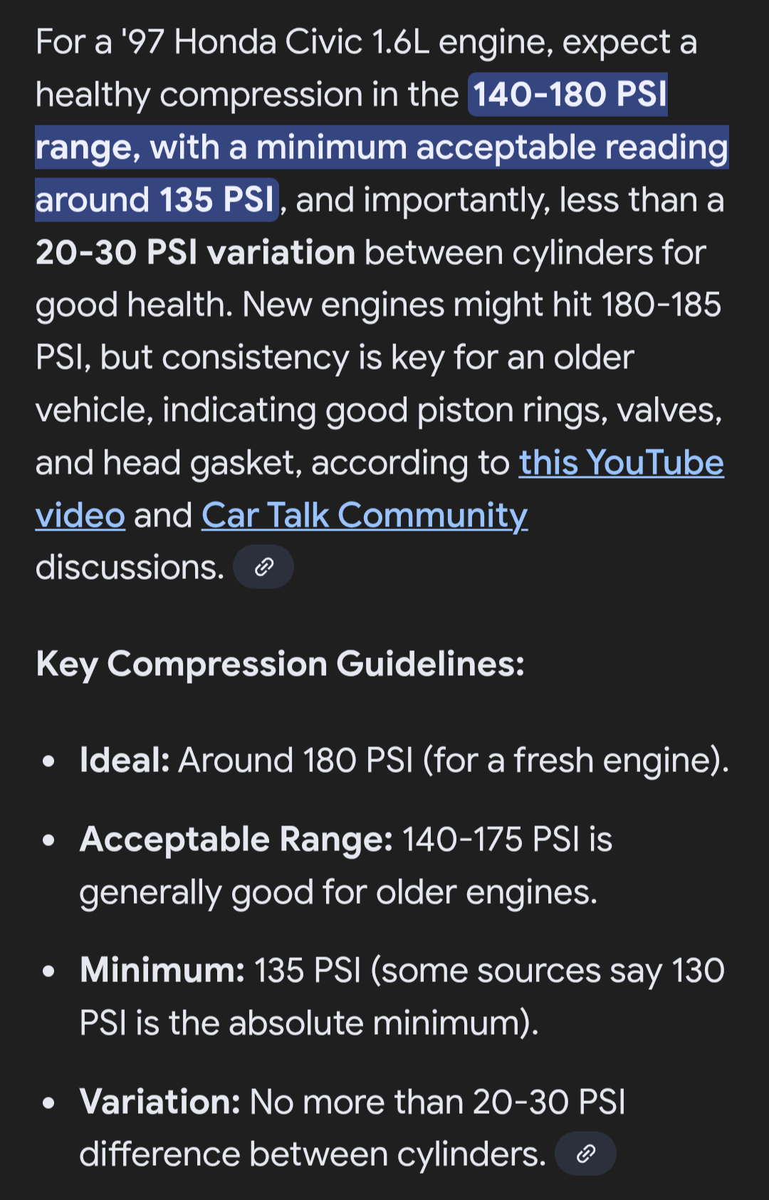

1.6L Compression Ranges:

If two cylinders are showing the "absolute minimum" of 130 PSI and under, this engine is running on 2 cylinders, 1 of those cylinders on it's way out at 145 PSI and oil on the spark plug.
Also the 175 PSI from cylinder 4 in variation difference of the other results is 30+ PSI.
I'm assuming this engine has had it and unless removed and rebuilt, it isn't going to start.
Correct me if I'm wrong, I'm just shooting my opinion on these results.

That compression is honestly better than what I'd expect for something with that mileage. All the cylinders on my '01 were around 110-120 at about 200k miles, and while it was completely gutless and burned pretty significant oil, it still ran okay. That's enough to run, regardless of the deviation.
If you hadn't told me that the injectors are working, I would've said that's a textbook fuelling issue. Your next option is to check sensors. I believe a bad crank sensor (I believe Denso's the OEM? Either way, avoid aftermarket) could replicate what's going on in the video, but I'm surprised it's not coding.
