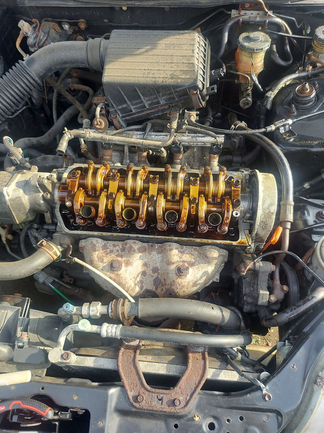

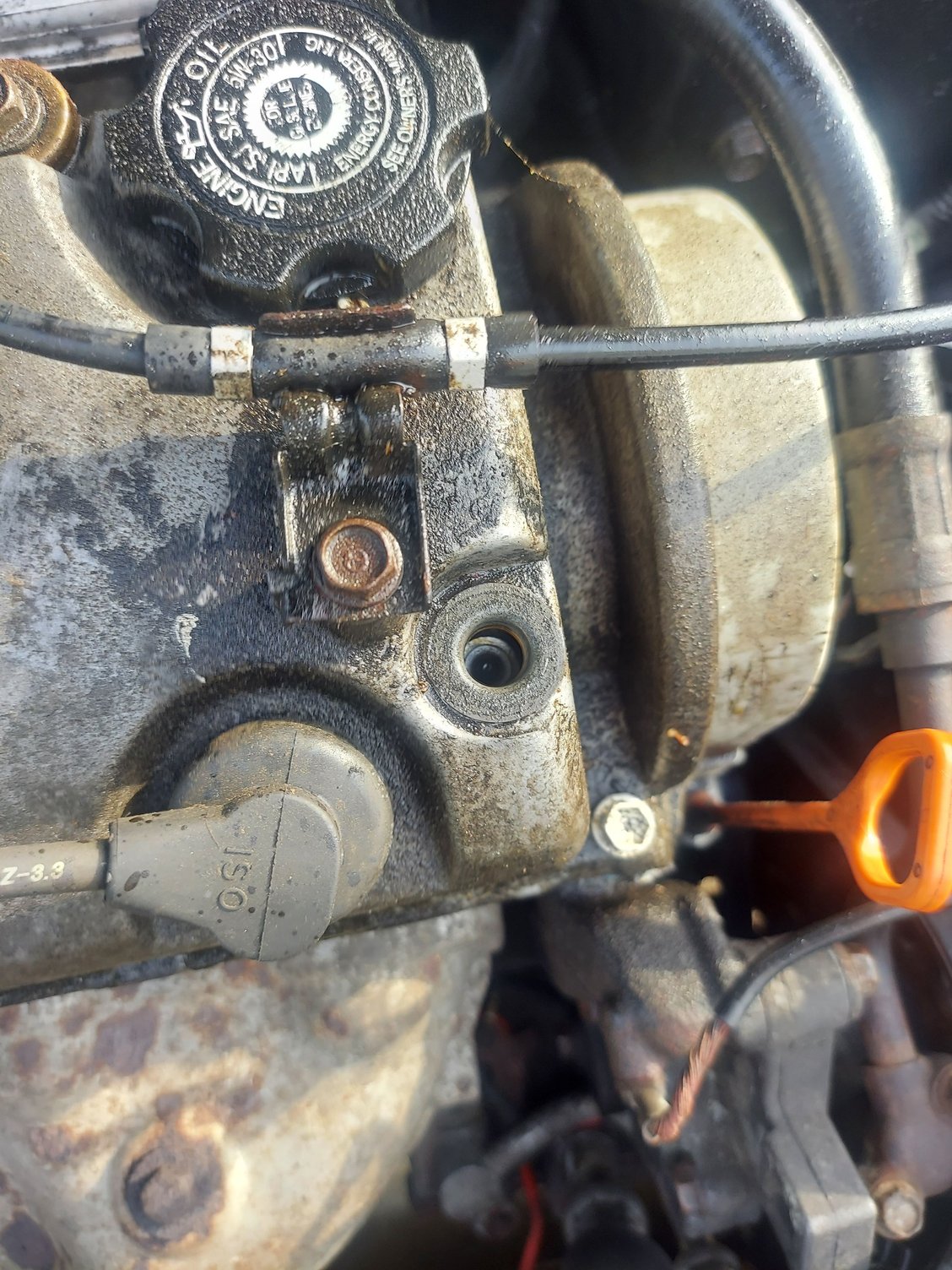

I have a 99 dx hatch(d16y7) that always ran fine but was missing a valve cover bolt. Took valve cover off today to take a look and was a broke bolt in the the threads. I tried extractor, but couldnt get a good bite, so i drilled out and helicoiled it. Put it all back together with same gaskets and new honda bond in corner spots, and now it sputters and temp guage is well over half way instead of below halfway. Anyone have any idea what could have happened? I did best to vacuum shavings while drilling and not let anything fall in. Would that be even a possibility of why this is happening? Any info is appreciated, tried google searching but cant come up with much.
