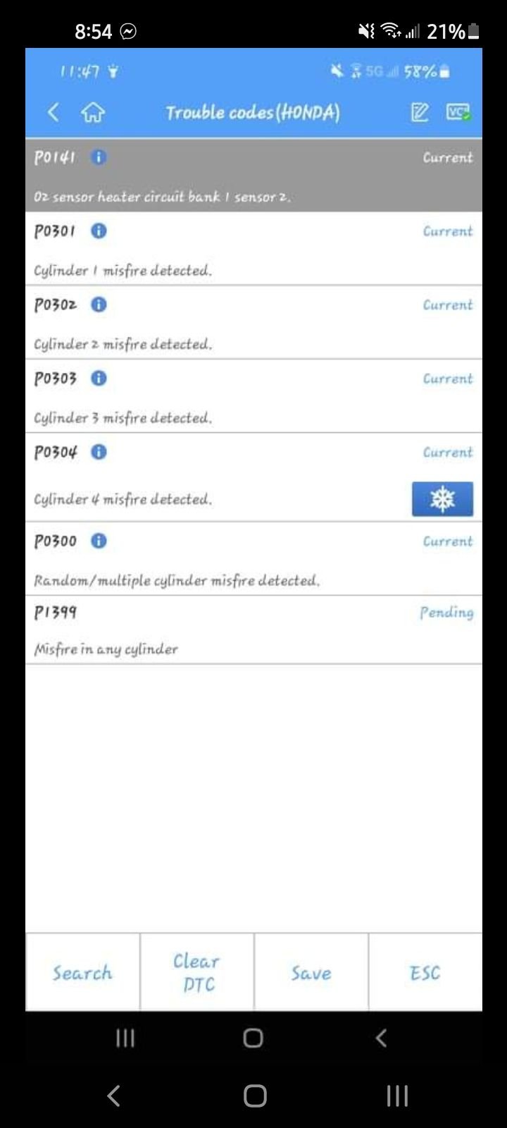

Has he replaced the O2 sensor? That's what a code is for and that'll cause a misfire.
Replace with OEM only. Aftermarket will not work. Denso or Honda brand only.

Apparently the O2 sensor code with pre-existing because the exhaust is broken before the second catalytic converter hes owned the car for about 6 months and never had a problem with the misfiring until a week ago he was driving and it stalled out on him and will not run he thought it was the spark plugs so he's changed them and used NGK plugs which helped the issue a little more cuz now it won't idle just fine but when you press the gas it bogs down and tries to stall out I have a video of what it is doing however this website will not allow me to post the video

As for the codes, perhaps it's a fuel issue. Certainly not ideal to leave the O2 sensor code, either.
