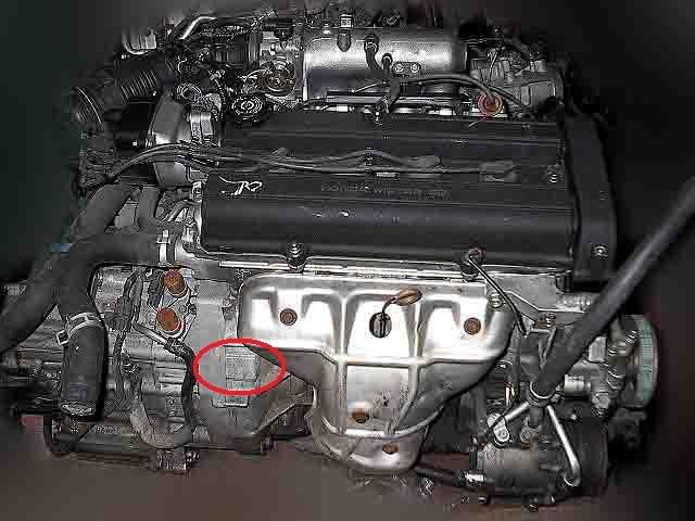

Hey guys new to the forum, my friend gave me a 98 civic lx sedan for free. Im thinking of do a restore maybe not sure yet. The engine has been swaped out for one of those Japan engines, milage unknown, size of motor unknown. I will say it runs great, the guy who gave it to me dumped like 2.5k into the various things wrong. So my first question is how do i find out what motor i have ? my second question is i have a 99 civic coupe radio with cd player that is brand new, will it fit into my 98 civic without mods ?. Thanks for any help you guys give me.

To find out what motor you have, stand in front of the engine bay, looks down and to the left (passenger side) of the exhaust manifold. You'll see a flat spot with an engraved alphanumeric code next to where the engine mates with the transmission. That's the engine code. If it's a 6th gen SOHC engine, I'd venture a guess you have a D16[xx]. D-series engine, 16 would denote 1.6L.
Granted, that pic is from, what looks like a B-series (DOHC engine), but the engine stamp is in effectively the same location
The 98 civic LX came stock with a D16Y7, a 1.6L SOHC non-VTEC engine, rated at 106bhp, 103ft-lbs torque
