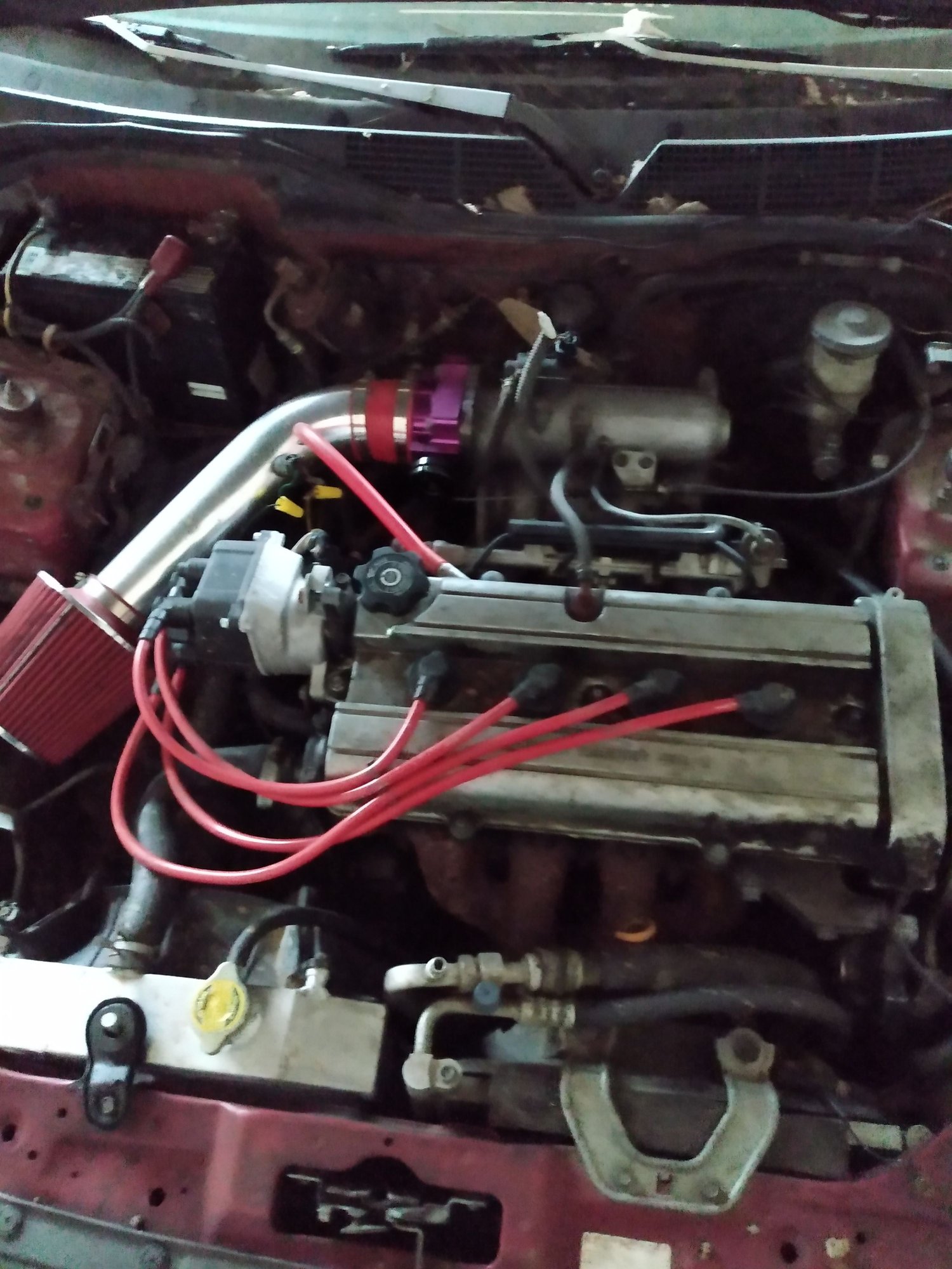

help me identify what head i have
i have a 98 civic ex coupe with has a b20b block with a b18 head so i was told, can yall tell me where to look to tell exactly was designation it is for the head ie like b18b head or something i need to buy a distributor thats one reason i need to know i think its just a regular integra LS head. thank you guys for the help, im trying to hunt down the reason for the idle when warm it idles at 1400 rpm and the idle adjustment is all the way to the lowest possible so i researched on the forum and i read alot about vacuum leaks, and the distributor is kinda jerry rigged so i figured id get the right one first any ideas throw them my way

yes sir it idles at a consistent 1300-1400rpm when warmed up and when starting it cold it sits at around 800rpm or so. if you put it in first and ease out the rpms will drop because your lugging it. but i will try cleaning the throttle body as u can tell its a cheap ebay one i didnt buy it it came on the car, and if that doesnt work ill try the smoke test for vacuum leaks. and also idk if i said this or not the idle adjust is all the way to the lowest possible, thank you guys
