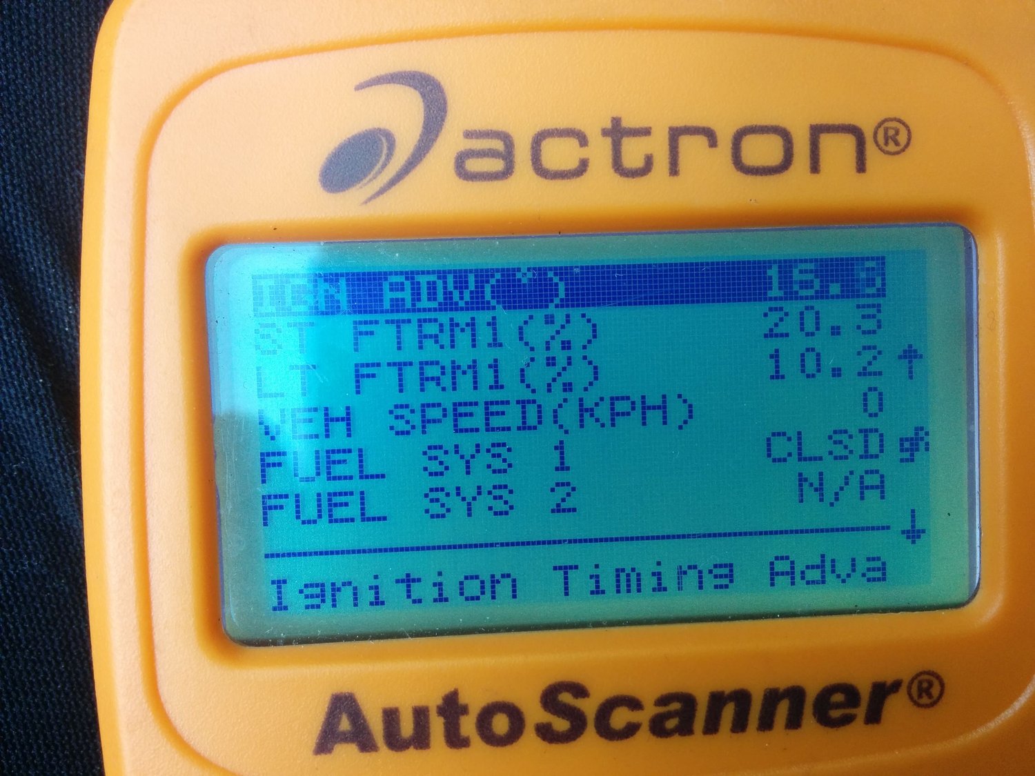

The LT and ST fuel trim on my 1999 Honda Civic DX are consistently reading above 10 at idle, but go down a little bit when the engine is revved up. I have looked around the engine bay for vacuum leaks and have tried the brake clean spray trick but have found nothing so far. The downstream O2 sensor's heater is broken for other reasons (probably electrical), but that shouldn't affect the fuel mix right? The car also seems to be low on power, but that might just be me because i have other cars and don't drive the car all that much. Is this a serious problem, or can i just ignore it (the car is a beater).
