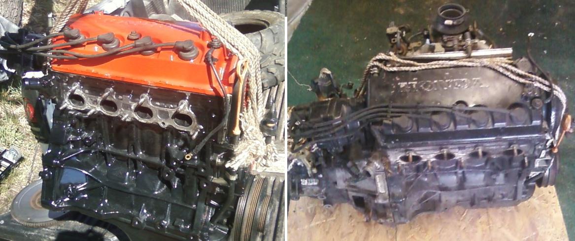

I have a 1997 Honda Civic DX, and i recently just rebuilt my car, and its all together and as it gets passed the Civics Built in choke, it slows the idle down to about 1.5 then starts jumping up and down to 1.5k - 2k and wont stop?
All the Spark Plugs are snug, they all are the same compression, the timing is perfect. Helppp.
FIXED ; IAC just needed cleaned. More or less, i change my throttle body back to the original one that was on it, ran fine.
