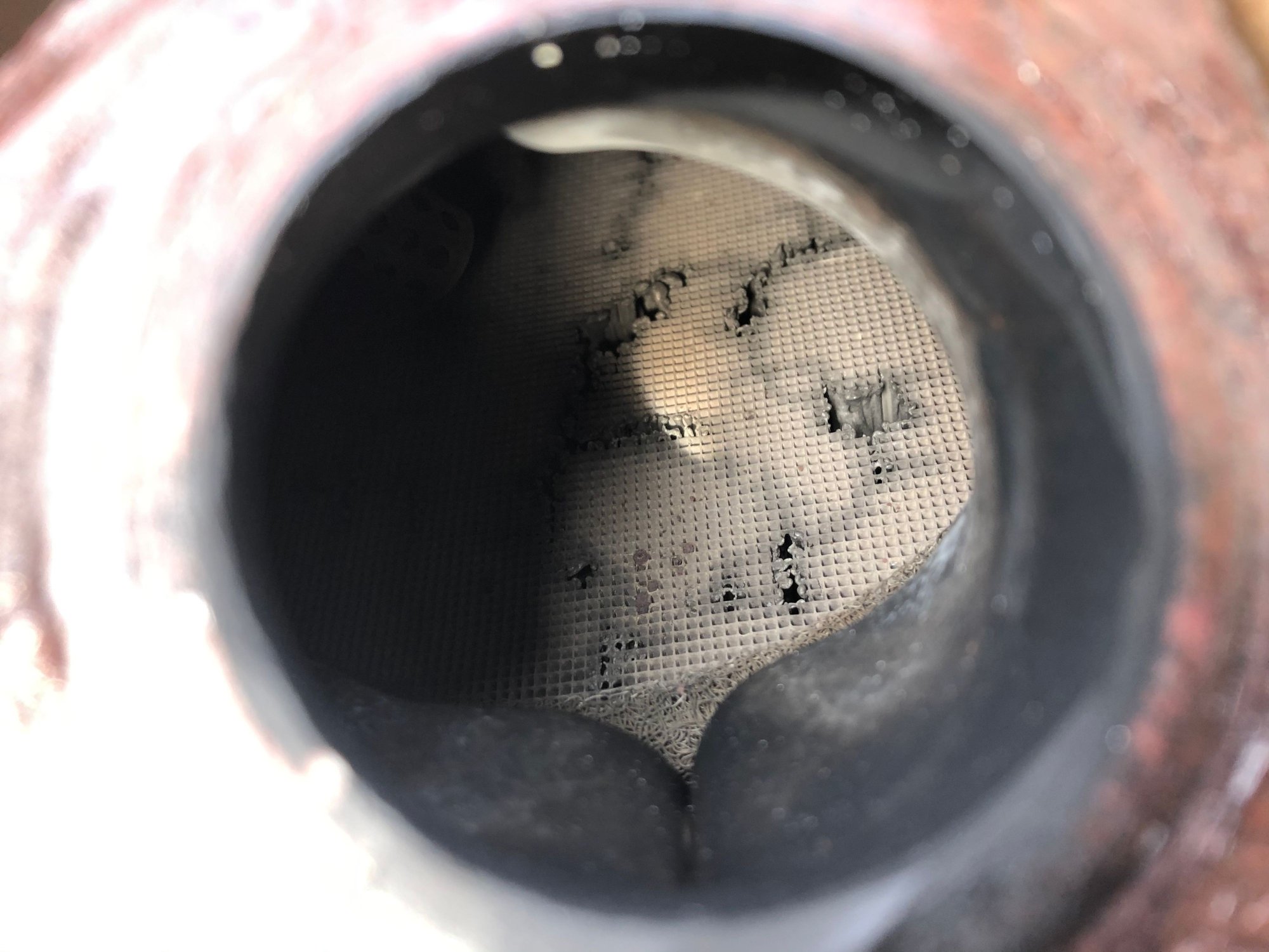

1999 civic with p0420 code. Hesitation and loss of power uphill. Does this looked toasted to you?

Yeah it doesn't look to be in the greatest shape any more, fyi the cheap cats will only last about a year before the computer thinks it's "bad"

May want to tap on the rest of the exhaust with a rubber mallet and listen for rattling to see if the exhaust is clogged

I just put an eastern aftermarket on it. I hear rattling by the resonator but I don’t know if I’ll have time to remove exhaust from pipe A back. I can barely lift my arms after removing old bolts all day. Hope it blows itself out. I bought the car for $1200 and didn’t like the idea of paying almost that much on one part. Thanks for the reply.

See how it drives, if it still feels sluggish and restricted then you'll have to check. Hopefully just the cat was the problem
