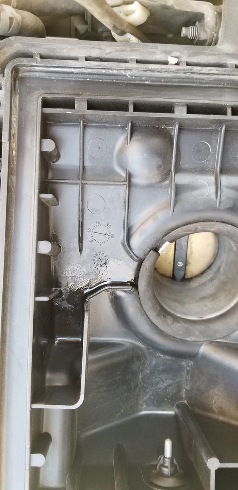

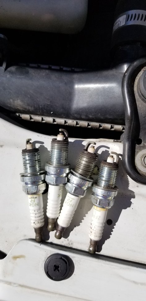

Well, did the leak down test and I think unfortunately the rings are shot. Unless I'm doing something wrong, but it seemed to be leaking so bad that the gauge wasn't even able to pressurize. All 4 cylinders sounded exactly the same, a ton of air coming out of the crankcase and through the dipstick hole. The strange thing is, other than the minor misfire that I started this thread about, it runs awesome! It's really got me stumped! The plugs have around 1k miles on them and they look brand new yet. There was a little oil in the airbox too that I don't believe was there when I started all this a little over a month ago, I know that could be caused by bad rings among other things. If it is bad rings, how can it run so good 99% of the time, and wouldn't the plugs at least show some signs of oil burning?
Here's a video of the test and a pic of the plugs and oil in the airbox.

Your car will still run fine with bad rings, but your compression will be crap, and you’ll be burning a ton of oil.
Another way to be sure: have someone drive behind you and absolutely floor the car. If you have blue smoke at higher rpm, then it’s also most likely rings.
Have you tried what Puffin suggested yet with the oil in the cylinders? Your compression will spike if your rings are bad.
