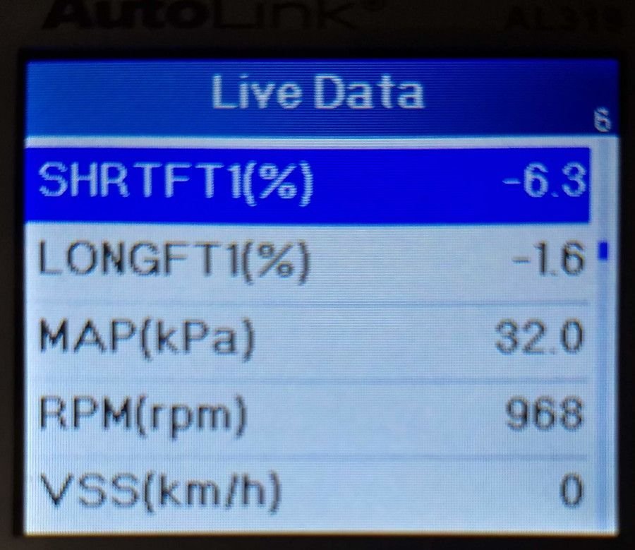

Since it showed no stored codes, I took photos of the live data when idling just in case it is helpful:
