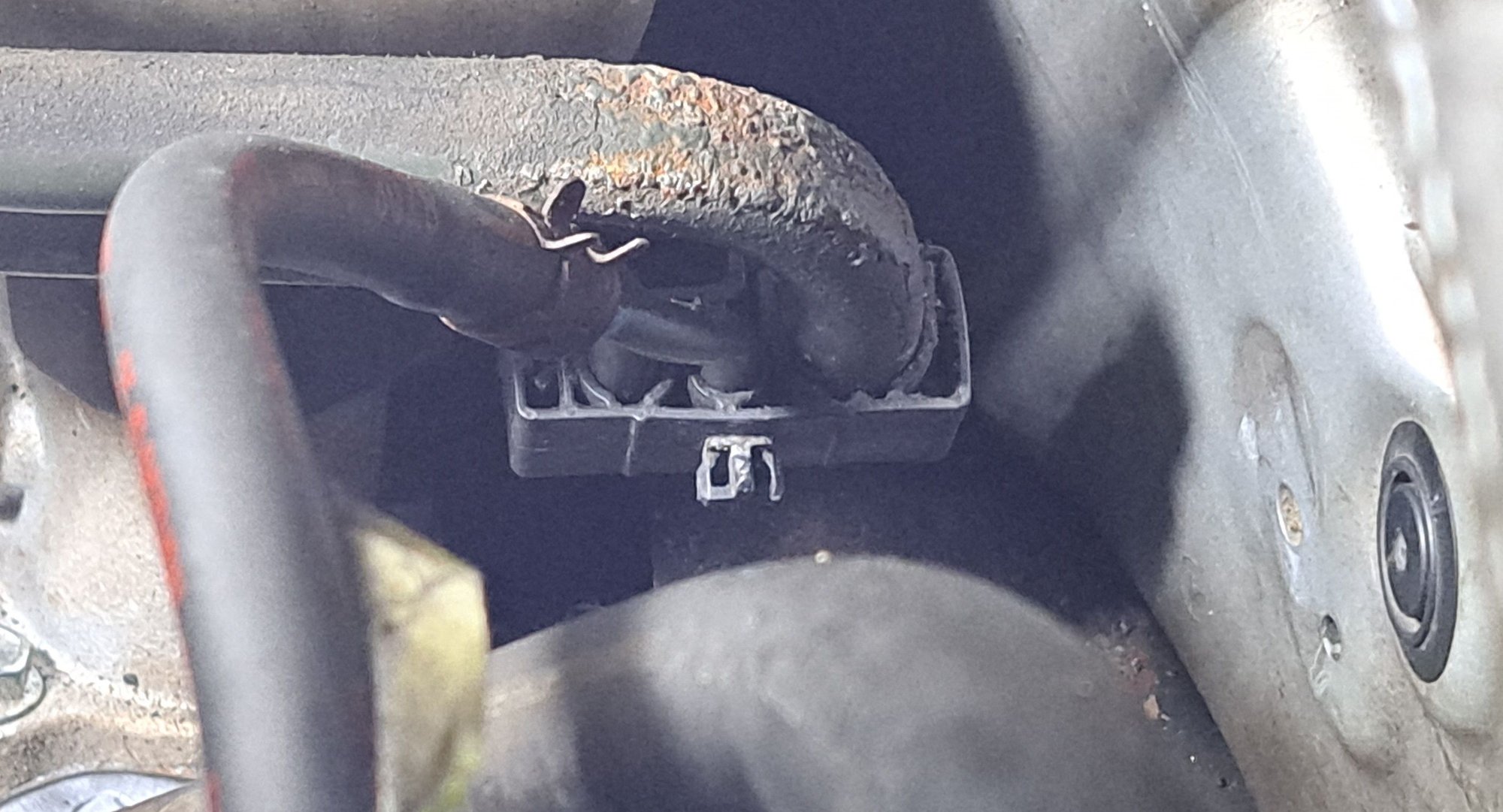

Does anyone know how to open and remove this so I can take out the pipes and hoses? I have a 1999 and its different from the videos posted earlier in this thread . This is where the evap, supply and return meet at the front of the firewall

On the left side you can see the little clip. Pick or a small flat head

Finally got it off. Was using a flathead screwdriver that was too fat.
