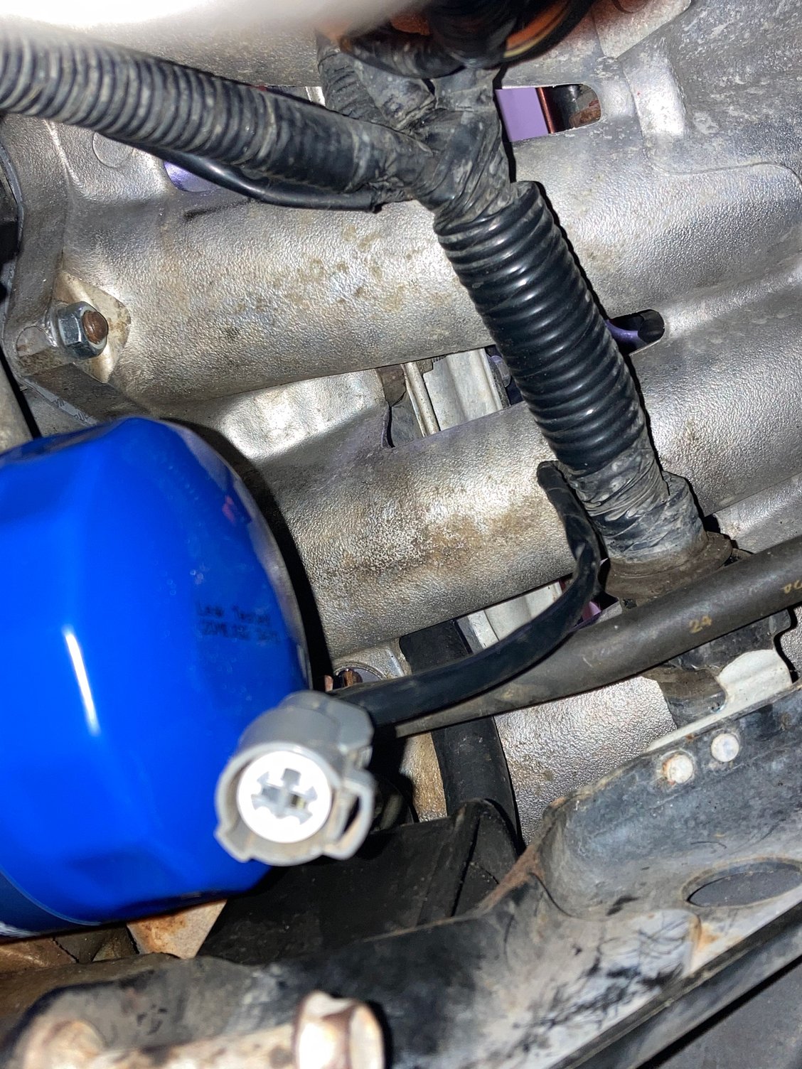

Any idea where this plug goes ?
Its a single red wire with a blue stripe. Comes out of the main harness under the intake, up above the oil filter. Cant find anywhere it could go. 97 Del Sol, DOHC.

Heres one more.

Not familiar with the Del Sol whatsoever but according to my '96-'98 Civic service manual I think that's for the knock sensor. Knock sensor would be a single wire in that area, schematic shows it's a blue/red wire. Do you have a fault code for it?
No code yet. I havent started the car. I fiund it changing the head gasket. Doing some research last night, thats what I was thinking it is too. Same kind of plug as pics I saw. Thanks alot man. With what I found and your input Im fairly certain thats what it is. Very much appreciated !
