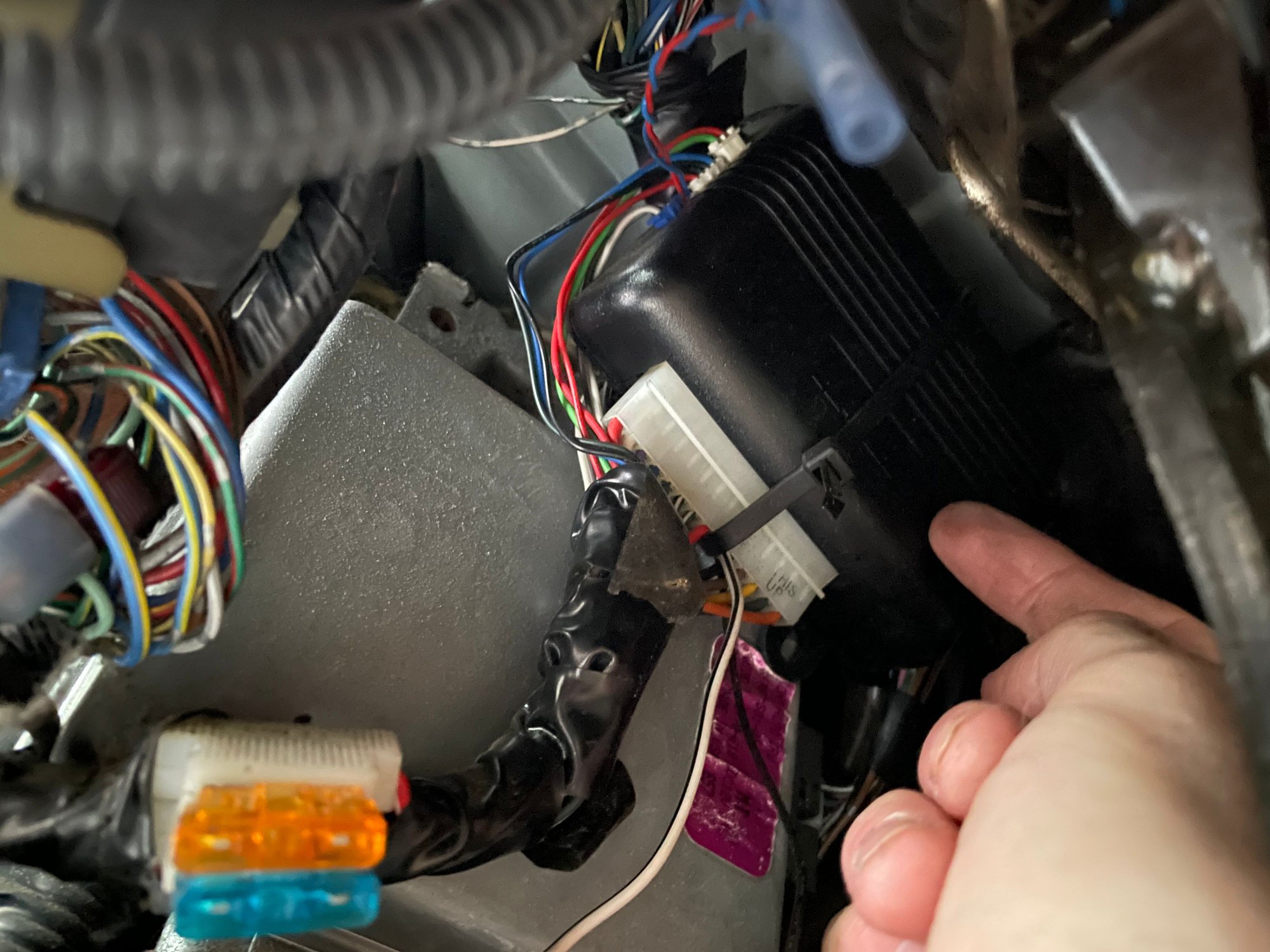

Well after digging around under the dash I followed the clicking back to this little black box that I believe to be an aftermarket alarm (that doesnt even work) that the previous owner installed. Upon removing the orange fuse all clicking stopped. Going to completely remove it and see how that works out.
