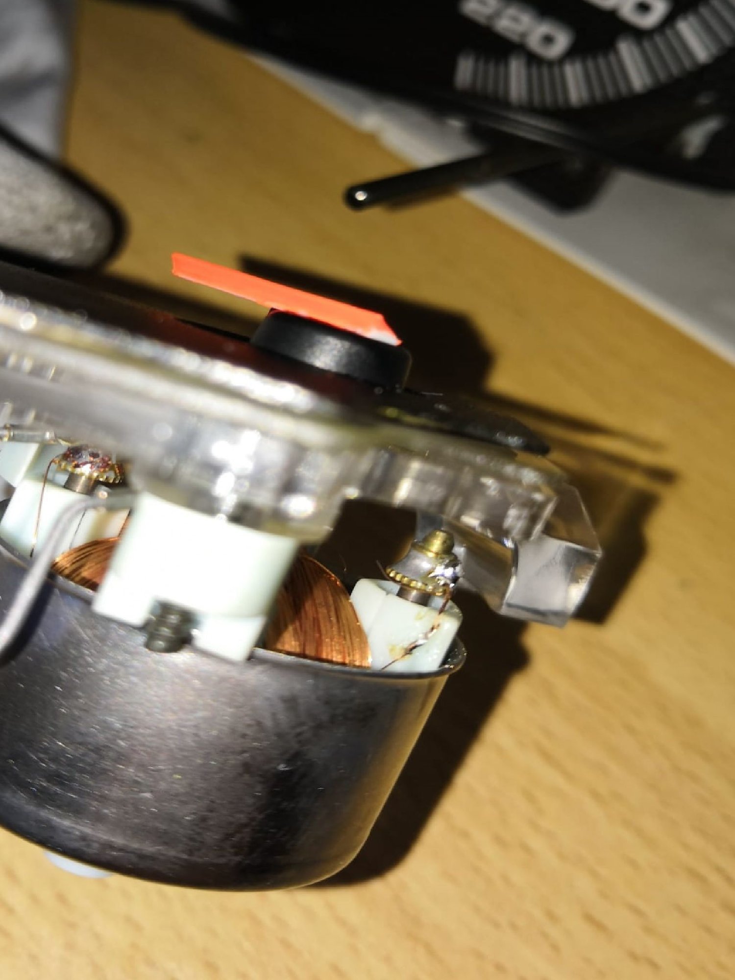

re: Fuel gauge stuck in Full [solved]
Maybe I can help you.
I've had a problem with the speed cluster, so I disassembled the quadrant, resoldered all the solder points on the outside circuit board, and it solved my problem with the speedometer but in the assembly process i snapped one of the screws of the fuel gauge and when i start the car always showed me full tank.
I´ve dissasemble again and check the fuel gauge support of the broker screw, the copper fillement snaped you can fix that by soldering the little copper filament again no neew to buy new gauge, be extra carefull with that screw on assembly.
So if you have probelms with your gauges
1º- resolder all the outside circuit board joints
2º-Check your gauges screws supports for snapped copper wires ,if yes them sold them, be extra carefull on assembly because they will rotate again
the tinny copper filament spnaped , just take one from old cable and resolder the screw joint to the copper bobine
Hope it helped
