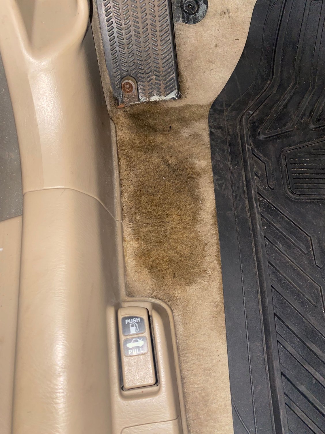

I have a 2004 Honda Civic ex and I keep getting this wet spot around this area only. There’s no water coming in because it hasn’t been raining at all for a week and I do have a floor cleaner that can suck up water and I did it before the week started and it’s been getting wet still. I did kind of notice it gets more wet when the car is running and being used so could something be leaking and getting it wet?

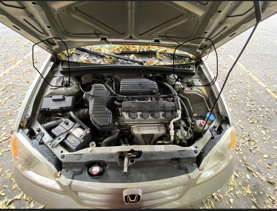

the leak turned out to be some old seam sealer that failed.
the leak area was at the area where the hood (when raised) met with the back of the front quarter panel.
if you lift your hood and look in that general area, you should be able to see what I’m talking about.
both sides were leaking so I loosened the front quarter panels and also removed the hood to give myself some working room. If the quarter panel doesn’t want to move, check the bolt that is only accessible when you open the front door.
then I peeled off the old seam sealer and put some new stuff on.

I found a pic online and circled the areas where you should be looking. You are looking for some old seam sealer (kind of like caulking, but it is a harder material). Mine was old, dried up and cracking. Once you remove the hood and loosen the rear of the front quarter panels, you should have enough room to fit your hand in there. Peel off any loose seam sealer and clean the area (I used brake cleaner) so that loose materials and dust / dirt is removed. Then apply new seam sealer

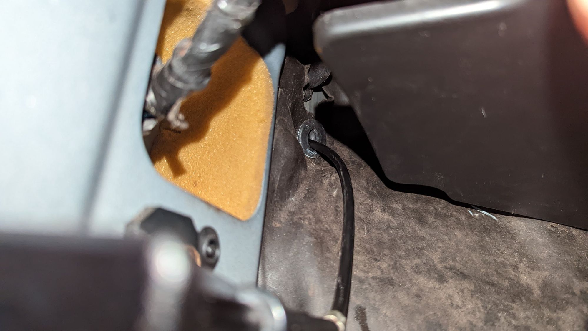

Just wanted to respond incase this same situation happened to anyone else. I ended up pulling my fender out to re apply that sealant like was suggested but it did not solve my issue. It did get me on the right track though so thank you very much for the help! For me it ended up being the little rubber grommet that plugs the hole the hood release cable goes through, I had to take the panel that goes over the hood latch out and peal up some layers to see it was just out and after having someone hold a water hose over my car I confirmed that water was indeed coming in through the hole.
This is the hole water was flowing in from for me.
How it looked after i reinserted the rubber piece

What I meant was the sunroof drain dumps directly on top of the hood release cable. Water will then run down the cable directly into the cabin if that grommet isn't seated properly.
