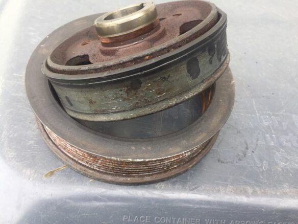

The outer pulley part is bonded to the center with rubber and after time they can separate

Check the condition of the woodruff key. It may cause the harmonic balancer to wobble a bit, regardless of how tight the 19mm bolt is.
But yeah, there's a big rubber grommet that holds the pulley in place. That's definitely a problem.

Please educate me as to this rubber grommet you are speaking of. Show me a schematic. I’ve done three different Honda timing belt and water pump changes and have yet to encounter a rubber grommet that helps hold the harmonic balancer to the crankshaft.
Old Jul 8, 2020
Rep Power: 518
Re: AC Alternator belt issues.
You don't know what you don't know.
Some aftermarket pulleys may not be constructed the same, but just about every engine on the road has one.

This is mine: one solid piece of steel.

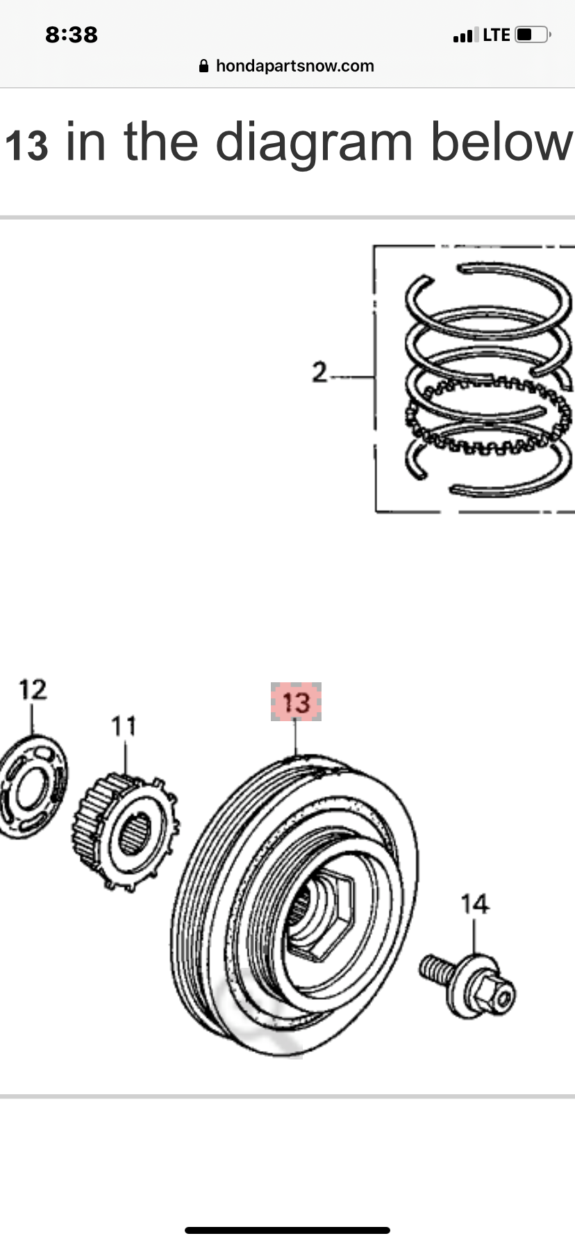

It's actually sold as a single piece, but you see that groove on the diagram? That's what they're referring to.

Considering an actual Honda mechanic told you it's two pieces, not to mention the rest of us telling you it's two pieces. Maybe you should stop arguing
